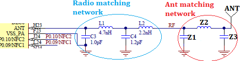

  • Hello and thanks for the quick reply.
     To avoid confusion latter on my part, the filtering part is this red circulated one right (from the picture below)? And that is wat i need? And any suggestions on what starting values to put on the antenna matching part?

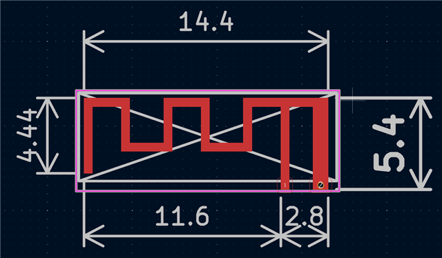

    What type of trace antenna are you planning on using?
    I am planing on using the stanrad 2.4ghz from texas instruments, they have that desing/footprint on kicad and i used that for desinging a bt atnenna with a Jieli AC695xx chinese chip and it worked fine (without the antenna matching part). It's the "Texas_SWRA117D_2.4GHz" The dimensions are:
    I will use the same footprint in the final version of the board, and in that new board with a different layout i will only need to change the Antenna mathing part right?
    Correct, Z1-Z3 is a pi antenna matching network. As as starting point Z1 and Z3 does not need to be populated, and Z2 can be a 0 Ohm resistor. The values must be determined by measuring the antenna impedance.
    This type of antenna should by design be close to 50Ohm, but there will still be external factors influencing the impedance.  It should be possible to tune this with just one capacitor(Z3 for example) and by adjusting the length of the antenna. This way of tuning will result in a change to the PCB after tuning, while using a pi network will only result in a BOM change after tuning.
    Yes, I would assume that the antenna will work OK without tuning for the test board. So I suggest only doing the tuning for the final board when the PCB enclosure is finalized, as the enclosure(even if its just made of plastic) can impact the antenna impedance. Tuning the antenna with the enclosure will allow for compensating for any de-tuning of the antenna.
