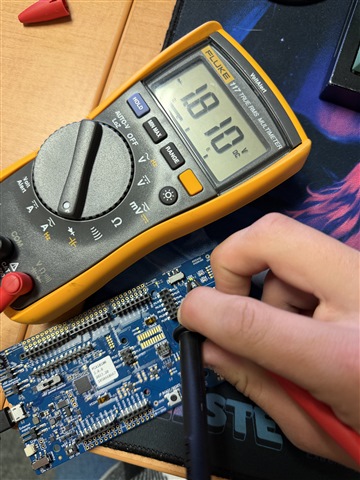

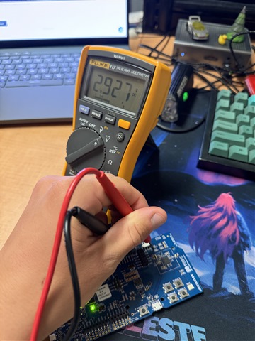

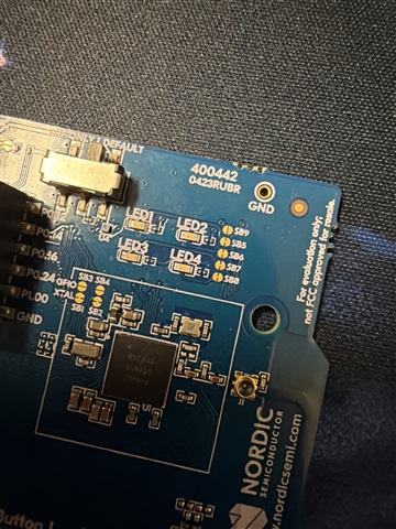

Hello, I have a particularly weird problem that I can't figure out how to solve. I was using the 52833 DK for software development and the onboard leds were blinking perfectly fine, but after a short break they don't seem to work at all. My previous code using the led api does nothing, the blinky example using GPIO api does nothing, and the developer academy lesson 1 and 2 don't do anything. But the LED definitely works. With a multimeter I can confirm that there is a voltage increase at the pins when the LED is driven, the diode test shows it working and if I bridge the right pad of LED1 with SB9 the LED will light up properly. The only conclusion I can come to is either that a software change made a difference in how the LEDs were drive or that the drive polarity in hardware somehow changed. I'm really at a loss for this one.

  • Not sure if you have done any changes to the board or overlay files, but normally the LEDs are active low (so driving pin low will turn the LED on). Looking at the picture you took it may look like you are measuring high on the pin controlling the LED? Though I can see you are toggling it from the code, but still mention it.
    Edit: Are you sure you are building for the correct DK?
    Kenneth
