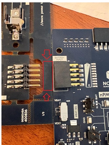

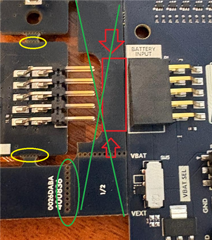

I CANNOT USE nPM 2100 EK WITH CR2023
Hello
nPM Power UP v 2.24 detects nPM2100 EK, but does not detect the CR2032 battery.
The active battery model selected is CR2032 and the fuel gauge is enabled.
I placed the CR2032 in the battery holder and connected it to Battery Input Connector on EK.
Two LEDs light up side by side: a red LED and a yellow LED.
I tested it with SW5 for VEXT and VBAT.
I have read this link.www.nordicsemi.com/.../Get-started
Regards
Luiz Miranda
  • Hi Luiz,
    I'm glad to hear that it works. I'm afraid we don't have a ready solution to connect CR2450 to the EK. I think the best way would be to buy a battery holder and use jumper wires to connect to the input. You can use the CR2032 fuel gage model, as the chemistry of these batteries are identical.
