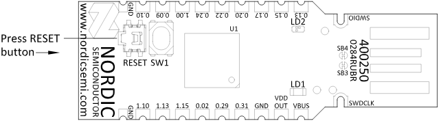

How do you program the BLE sniffer code into the NRF52840 dongle?
    You must put the dongle in bootloader mode first. To do so, press the RESET button and wait for the LED LD2 to pulse red.

  • I have tried that and see the LED pulse RED, but the Erase and Write functions remain greyed out, so it is not possible to program the .zip file.  I am able to program a Hex file on the Dongle (nrf802154_sniffer_nrf52840dongle.hex), but the nRF programmer (v4.7.4) doesn't like the zip file (sniffer_nrf52840dongle_nrf52840_4.1.1.zip).
