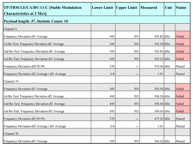

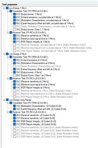

Does nRF54L15 support BLE stable modulation characteristics at 1Mb/s & 2 Mb/s..., if we meet related issue, how to debug on HW and SW side?
Dear Nordic Team and Distributors,
For nRF54L15 (CSP and QFN) design circuits, how to optimize the stable modulation issue?
What aspects should we consider to do failure analysis to debug this issue? For example, power rail, RF front-end, and matching circuits
Please help to provide relevant debugging documents or instructions
