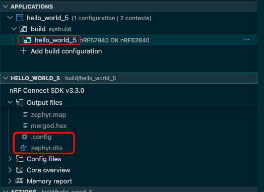

    I am surprised you see the same without DPD as well. To help troubleshoot this further, could you try to compare/"diff" the .config and zephyr.dts from both builds? I can also diff the files here if you upload them here.

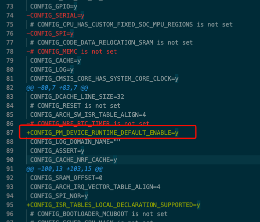

  • Thank you. One difference that stands out is that the new version has this config setting enabled:
    With this option, the flash IC is automatically put into DPD mode between use. Could you please try disabling this?

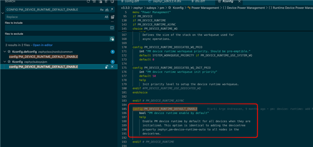

    Is this a kconfig entry added because the specifications for the Zephyr driver have changed?
    In which source code of the Zephyr driver is this kconfig referenced?
    Also, since this config is for automatic power control, even if I turn it off, I can still put it into low power mode using the pm_device API, right?
    The "why" is summarised in the commit message here: https://github.com/nrfconnect/sdk-zephyr/commit/61a9d6aa45868d65b4d24c257a2799a62fb9d32d
    Your original version already had CONFIG_PM_DEVICE_RUNTIME enabled, but that did not do anything for the SPI NOR driver since we aren't including the "zephyr,pm-device-runtime-auto" property in the SPI node by default.
    Yes, you can.
