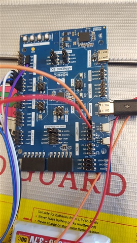

no device npm1300_ek (one button sample) with nRF52 DK on I2C Bus
I try to get the one button sample to work. There were several details missing to be able to compile and run this sample, which was very frustrating. After editing/updating the

with claudes assistance/support i got it to compile and run. But an i2c scan i2c0 shows no device at all.
What minimal required steps/configuration have to setup to get I2C enabled and detect devices on the bus should be?
Trying with the nrf-connect (Ubuntu) Linux-Desktop app (2x USB -C, 1x LiPo Battery) i get NPM detected, the LiPo Battery to and can change parameters for ex. the LED's live, so the BOARD is working.
Any support/hint/help is appreciated.

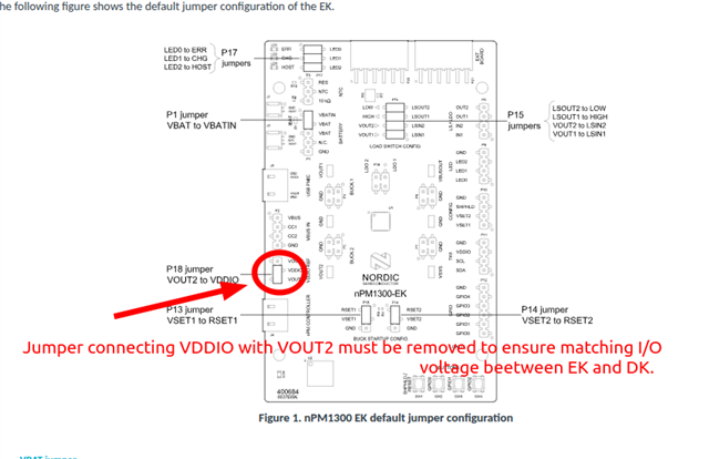

    You should not need to alter anything when compiling the example:
    https://docs.nordicsemi.com/bundle/ncs-3.3.0/page/nrf/samples/pmic/native/npm13xx_one_button/README.html
    Please note that the "npm1300_ek" shield uses i2c0 on the nrf52dk, and not i2c1.
    Same goes for the zephyr sample:
    https://docs.nordicsemi.com/bundle/ncs-3.3.0/page/zephyr/samples/shields/npm13xx_ek/index.html#npm13xx_ek
    Here you need to set the shield parameter (as you do in CMakeLists.txt):
    https://docs.nordicsemi.com/bundle/ncs-3.3.0/page/zephyr/samples/shields/npm13xx_ek/index.html#building_and_running
    Håkon

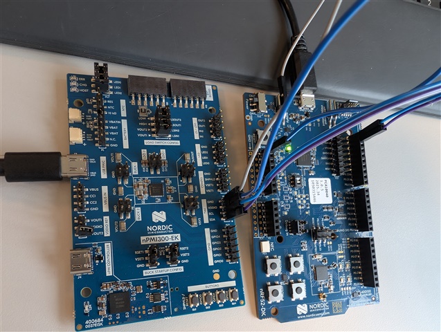

    editing an example was my fault. But Using I2c0 is no difference. Tried with the original sample npm1300.overlay.
    I additonally enabled the shell in the prj.conf:
    CONFIG_PRINTK=y
    CONFIG_LOG_CMDS=y
    CONFIG_I2C_LOG_LEVEL_DBG=y
    CONFIG_SHELL=y
    CONFIG_LOG=y
    CONFIG_UART_CONSOLE=y
    CONFIG_EARLY_CONSOLE=y
    CONFIG_I2C_SHELL=y

  • *** Booting nRF Connect SDK v3.3.0-ba167d9f3db4 ***
    *** Using Zephyr OS v4.3.99-fd9204a02d52 ***
    Set up button at gpio@50000000 pin 13
    V: 4.165 I: 0.0001 T: 24.79
    Charger Status: 5, Error: 0, VBUS: connected
    V: 4.165 I: 0.0003 T: 24.79

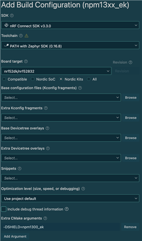

    Good, this means that the setup is working with the precompiled .hex that I shared.
    Then I suspect the issue is how your firmware is setup, ie. built.
    Try to delete your build folder, do not add any specific overlays or .conf files; and only set the SHIELD parameter, similar to this:
    Since we cannot overload the west cmd switch here, we just set the EK directly in CMakeLists.txt:
