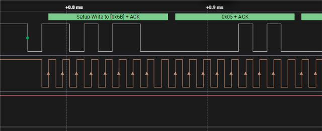

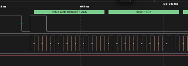

In bare metal code, we are able to get acknowledgement sometimes.

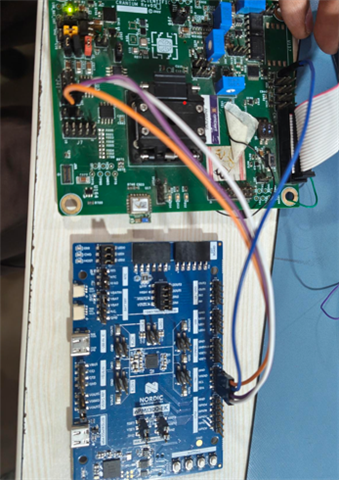

    As the I2C communication sometimes work but is unreliable the first thing that comes to mind is if you have long jumper wires when testing, perhaps combined with too weak pull-up resistors? I would suggest shortening the wires and using stronger (lower resistance) pull resistors.
    we have tried with other pull up resistors still getting same results. we will once check by soldering the PMIC i2c pins with our mcu and will let you know the results.

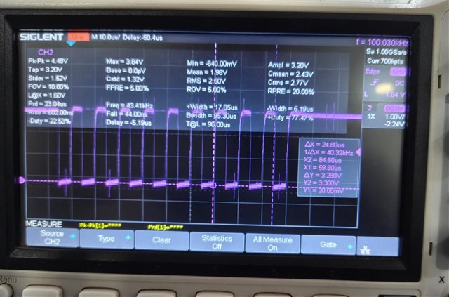

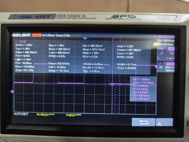

    We are observing intermittent behavior on the I²C bus. In some cases, we receive the ACK response correctly; however, at other times the SDA line remains stuck low and does not return high. After performing approximately 2 to 4 reset cycles, the SDA line is released and returns to the high state, after which communication resumes normally.
    SDA going low:

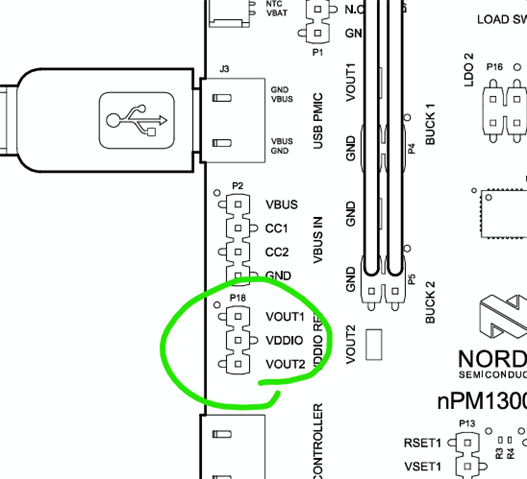

    This looks fairly good I think. You have VDDIO to VOUT2, and from the photo it looks like RSET2 is shorted to VSET2 (see Buck startup configuration), so the startup voltage should be 3.0V. I would assume that should be OK, but you could replace the resistor to get 3.3V as you write your MCU uses (see VSET).

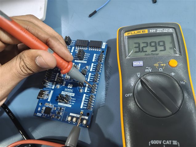

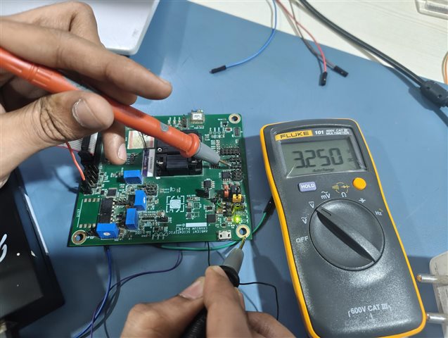

    Can you double check (measure) the VDDIO voltage levels on both sides and show here so that we see clear evidence that you are using the same level? There is no VDDIO connection between the two boards, so you need to configure the same voltage on both ends. If that is not the case, and for instance the VDDIO voltage on the MCU is significantly lower, it could be that the logical 1 is in an undefined range seen from the nPM, in which case it could be expdected that comminication sometimes works, and sometimes fails. This is a key factor that shoudl be properly understood.
    Also, are there any level shifters or similar between the nPM and MCU (I do not know what the MCU board contains in the signal path). Any information on that could be usefull.
    The plot from June 2nd, can you confirm that it was measured on the nPM side?
    If the voltage level is the same on both the nPM and MCU we need to look closer, and then I would re-iterate the ask for a oscillioscope (analog) plot close to the nPM that shows both SDA and SCL (not just a logic analyzer plot, as that does not show us any information about the signal integrity).

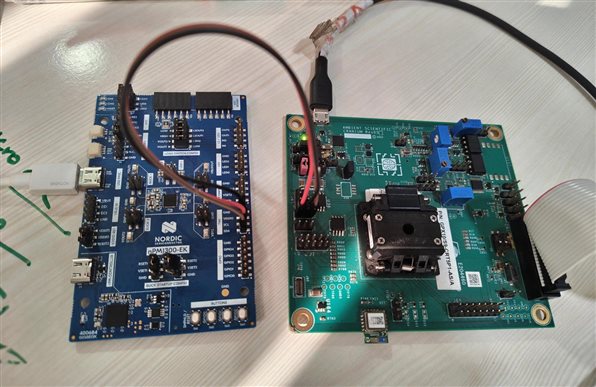

    please find the attached pictures regarding voltage calculations
    nPM VDDIO:
    our mcu VDDIO:
    yes it was measured from nPM side and there are no level shifters in between nPM and our MCU we are connecting SDA and SCL(which has 1.8Kohm pull up resistors) along with GND pins directly to the nPM from our MCU.
  • That looks good. Please shere a SCL/SDA measured with oscilloscope when you are able to make that as well, as mentionned before.
