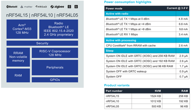

According to the nRF54L15 product specification / datasheet, the sleep current for:
is listed as approximately 2.9 µA. Since the nRF54L15 has 256 KB RAM, I expected that it should be possible to observe a sleep current close to this value under the proper low-power configuration.

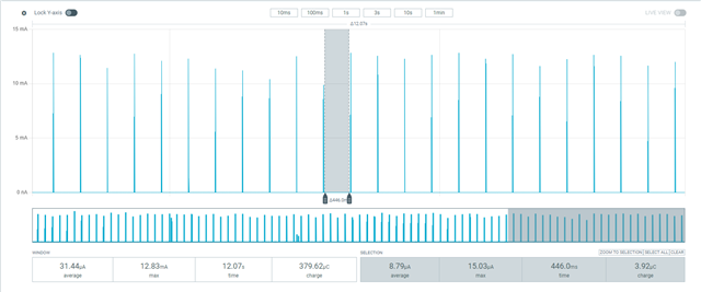

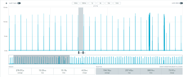

Test 1: Original sample without modifications
First, I built and flashed the sample using the original prj_release.conf without any modifications.
In this case, the measured baseline current was about 194.18 µA.
Test 2: After disabling shell/banner/early console
I suspected that some UART/logging-related functionality might still be enabled, so I added the following configurations to prj_release.conf:
CONFIG_CHIP_LIB_SHELL=n
CONFIG_NCS_BOOT_BANNER=n
CONFIG_BOOT_BANNER=n
CONFIG_EARLY_CONSOLE=n
After adding the above configurations, I rebuilt and flashed the application again.
The measured baseline current dropped significantly, and the lowest current I observed was about 8.79 µA.
This is much better than the original result, but it is still higher than the 2.9 µA value listed in the datasheet for System ON IDLE with GRTC and 256 KB RAM.

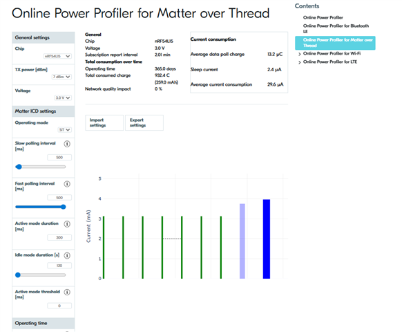

    I also tried the Online Power Profiler for Matter over Thread. With nRF54L15 selected, the tool reports a sleep current of about 2.4–2.5 µA, depending on the selected parameters. This is close to the datasheet-level sleep current.

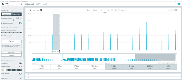

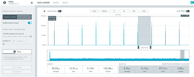

  • Hi Amanda,
    I did one more test and found a very strange behavior.
    Based on my previous low-power configuration, I additionally disabled the sample LEDs:
    CONFIG_NCS_SAMPLE_MATTER_LEDS=n
    With this change, the observed sleep baseline current dropped to around 7 µA.
    Then I tried to additionally disable the sample watchdog:
    CONFIG_NCS_SAMPLE_MATTER_WATCHDOG=n
    After this change, the sleep baseline current dropped further to around 3.5 µA, which is much closer to the expected low sleep current level.

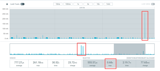

    However, I observed very abnormal current spikes in the PPK measurement. The peak current can even exceed 500 mA, which does not look normal for the nRF54L15 DK running this Matter sample.
    Could you please help explain why disabling CONFIG_NCS_SAMPLE_MATTER_WATCHDOG reduces the sleep baseline current to around 3.5 µA, but also causes such extremely large current spikes?
    Is the watchdog required for this sample to operate correctly, or could disabling it cause the device to enter an abnormal state such as a crash/reboot loop or another unexpected condition?
    I will attach the PPK screenshot showing this behavior.
    Thanks.

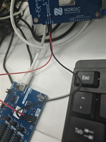

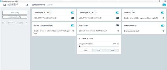

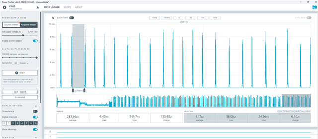

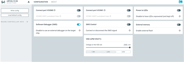

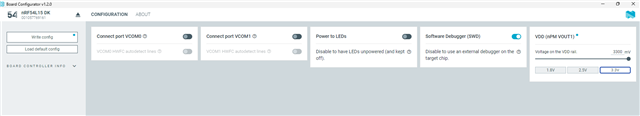

    I measured the current on the DK after running this window_covering sample. Only changed I have made in the application is adding the follwoing configs in the prj.conf file
    CONFIG_SERIAL=n         # Do not initialize UART logger module
    CONFIG_POWEROFF=y       # System OFF library
    And setting this configuration on the Board configurator
    I got average current 4.16uA. PPK was on source meter mode and supply voltage is as same board configurator's supply voltage.

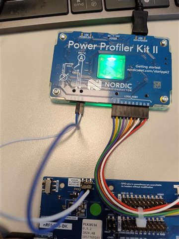

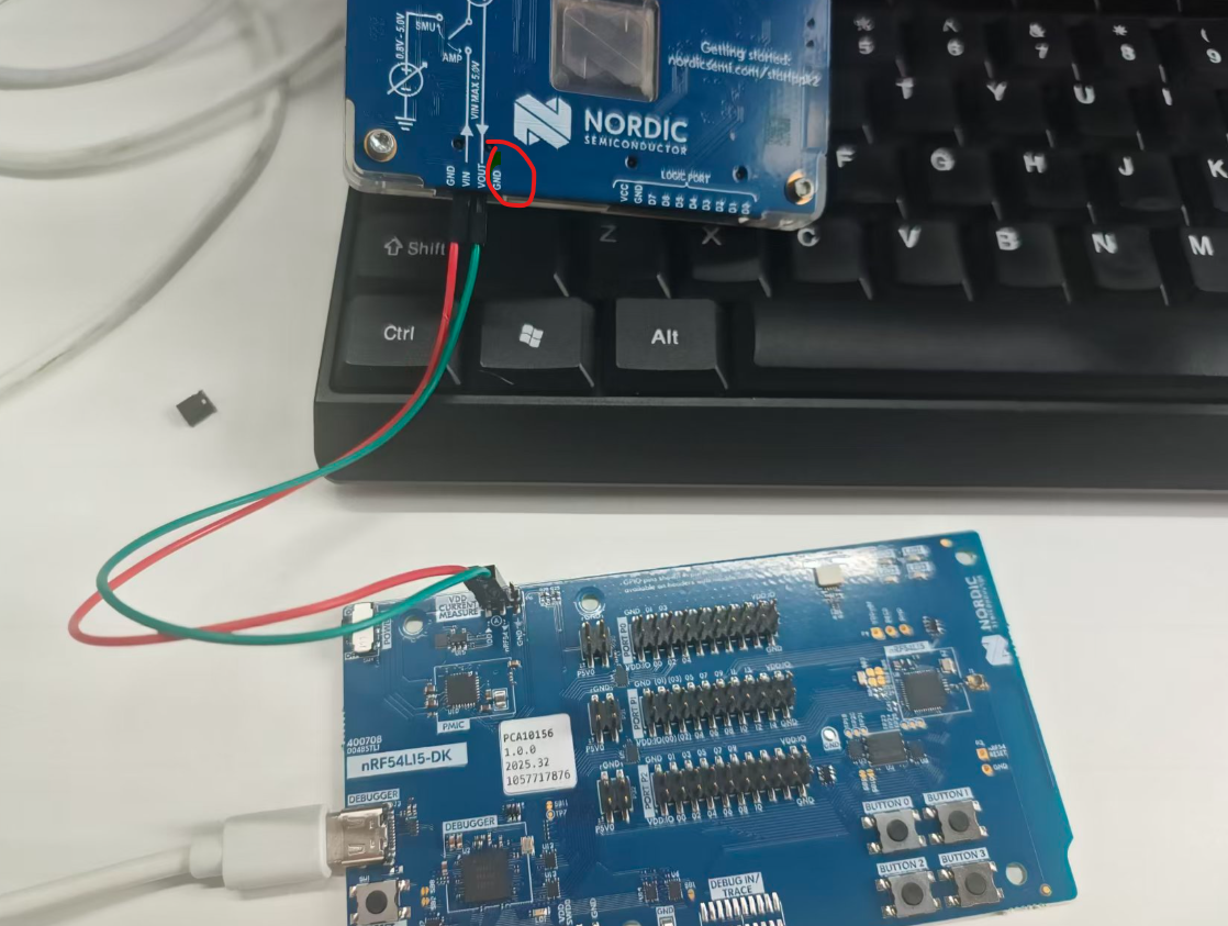

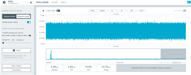

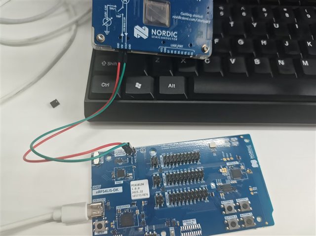

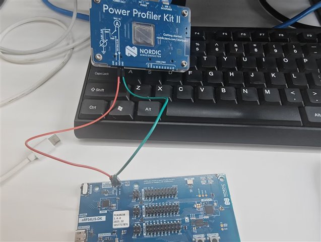

    However, in my setup, the measured sleep current is still around 8.x µA, and I cannot observe the 4.16 µA average current level shown in your screenshot.
    One difference is that I am using the PPK in ammeter mode, measuring through the VDD CURRENT MEASURE point on the nRF54L15 DK, while you used the PPK in source meter mode.
    Could this difference in measurement mode explain the difference between my result and your result?
    Also, could you please provide the exact wiring method for measuring the nRF54L15 DK current in PPK source meter mode? I am not fully sure how to connect the PPK to the DK correctly when using source meter mode.
    If possible, could you also share the firmware image that you used for your test? Then I can flash the same firmware directly on my nRF54L15 DK and compare the measurement result under the same firmware configuration.
    In addition, based on your configuration, I also tried disabling the sample watchdog:
    After disabling the watchdog, I still observed the same abnormal behavior that I mentioned earlier: the sleep baseline current decreases, but very large current spikes appear in the PPK measurement. The peak current can exceed 500 mA.
    Could you please try to reproduce this behavior on your side and help investigate the reason? I would like to understand clearly why disabling the sample watchdog causes such abnormal current spikes.

    My target is not exactly 2.4 µA. My reference target is closer to 2.9 µA, because this is the value mentioned in the nRF54L15 product specification for System ON IDLE with GRTC and 256 KB RAM.
