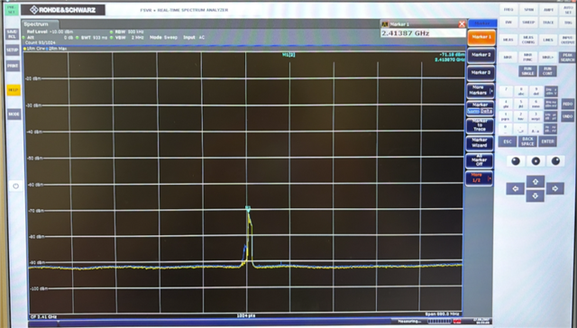

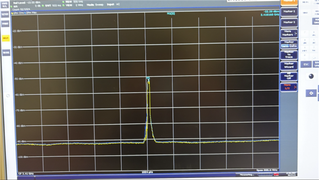

No! i have done only the radiated emission measurements with 1m of distance between radio module WM02F and the e-field probe, the e-filed probe was connected to the Network analyzer. The WM02F has an integrated antenna.
I only swapped the radio module (sourced from different suppliers) on the same hardware (changed the WM02F WiFi module on same PCB) and non of theme are made by me. My test setup was as below,

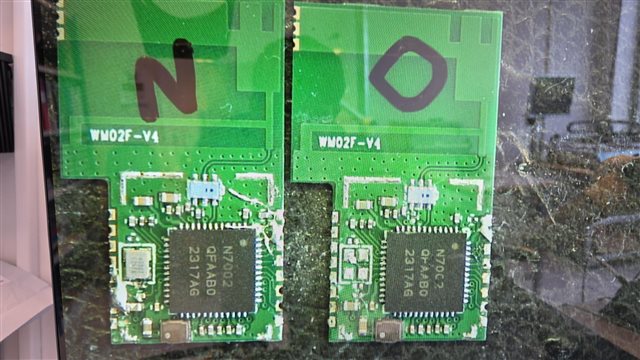

Is it possible for you to send a picture of the modules with the shielding cap removed?

Please see the module below,
N is the variant with lower TX power and O is with the ~20dBm higher TX power.
i have been swapping some components from the O variant to the N variant just to test if there is any difference (NOT the N7002 chip itself, but only the passive components). From the start both modules had all the components mounted (i.e NO missing component).
Only missing components were around the 40MHz crystal caps on both O and N variants, but i guess they are left NOT Fitted by the manufacturers!

Have you tried swapping the chips? It would be great if you could provide some conducted measurements so that we would be able to review a bit better. It is also possible that there could be some random fault or that the issue is occurring due to the diplexer being broken. Do you have any more of these modules?

no i have not swapped the chips and thats what i think could be the issue and asking for your help to verify!
I have tested on 4 different modules with the same results. i have a couple of spare modules and i am working on swapping different components on these just for verification but as of now i have not any results!

Our hardware expert has suggested that the next step would be to swap the chips as well so that we get to know if it is the board or the chip which is causing the lower power.

now i have swapped all the components on the module without any change in TX power. so my guess is it is the chip itself. and it is almost impossible for me to swap the chip on the module without damaging the chip/module! (sorry not very good in de-soldering the QFNP modules).
is there any other thing we need to look into? firmware?

We thought that you were using two different modules, one from Fanstel and one from Jetreq. From the picture you shared, both seem to be the same so a suggestion would be to contact Fanstel about this.
