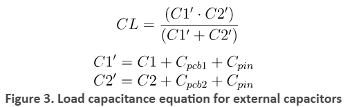

nRF54LM20A:
Cpin is the pin input capacitance on pins XC1 and XC2.
nRF54LM20A:
Hi
The Cpin_HFXO input capacitance capacitance typical value is listed in page 1261 of the nRF54LM20A datasheet: https://docs-be.nordicsemi.com/bundle/ps_nrf54LM20A/page/pdf/nRF54LM20A_nRF54LM20B_Datasheet_v1.0.pdf
We don't have maximum or minimum values specified I'm afraid, is there a reason you specifically need that?
Simon
Thank you for reply.
Can you explain what you mean by "take the tolerance of Cpin"? Is this a value you want from us?
Simon
Hi
Please see the OSCILLATORS chapter for how to calculate the load capacitance when using external capacitors:
When using external capacitors, the load capacitance (CL) is the total capacitance seen by the crystal across its terminals and is calculated by the equation above. C1 and C2 are the external capacitors. Cpcb1 and Cpcb2 are stray capacitance on the PCB. Cpin is the pin input capacitance on XC1 and XC2. When you use the external capacitors you should disable the internal capacitor by setting OSCILLATORS.XOSC32M.CONFIG.INTCAP to 0.
