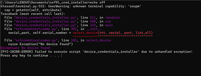

I am facing an issue with the latest nrfcloud-utils provisioning flow when using a custom nRF91-based board connected through a generic FT232R USB-to-TTL adapter.

Current issue
In the latest nrfcloud-utils, this logic appears to have changed and I can no longer provision custom boards using FTDI adapters.
This is the error i'm seeing:

However, the provisioning utility fails to detect or use the FTDI interface.

  • When I ran the script with --port PORT and --cmd at this is what I get:

    Which adapter are you using? The FT232R itself supports Hardware Flow Control but maybe the board you are using don't. But if your board supports Hardware Flow Control, then I'm not sure why it doesn't work with it enabled...

    The communication backend was changed from version 3.0.0 onward to nrfcredstore as part of a refactoring of the application.
    This "usb_patterns" array is now located in nrfcredstore/comms.py (link).

    I'm using a custom FDTI adapter, it doesn't have flow-control. By disabling flow-control  with --rtscts-off I got it working. The only problem now is that I cannot auto detect the com port. I have to specify the com port using --port to get this working, so I wrote a custom python script to auto detect the com port and pass it to device_credential_installer. Now everything works fine.
