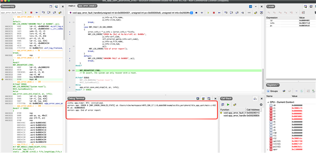

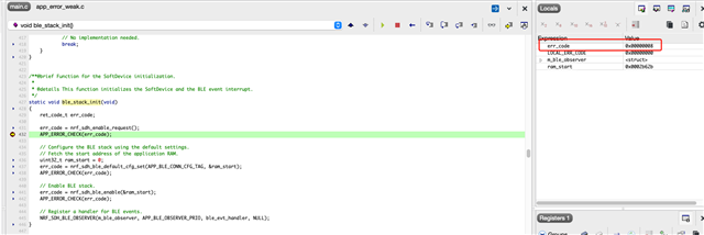

Failure in ble_stack_init during startup
We are trying to bring up a new run of an existing PCB design. No changes in the area of the processor, but a different assembly house. The first call inside ble_stack_init, a call to nrf_sdh_enable_request(), fails and returns an error code of 8. No reference anywhere gives a usable explanation.
Strangely, if started by "copying" the hex file onto the Jlink "drive" (the nRF52832 DevKit), it succeeds.
What should we be looking for?

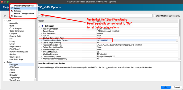

    It seems like the issue might be with how the firmware is programmed since it appears to work when you use drag&drop programming. How are you programming the device when it fails? Is the same error also returned after a reset? Note that the "SoftDevice enable" function may return NRF_ERROR_INVALID_STATE (8) if the debugger forces execution to start from the application start address instead of address 0x0. This prevents the softdevice's reset handler from running on startup.
    Vidar
  • I was starting it from SES (Segger) just as I have on dozens of previous nRF52832 projects, and indeed successfully on previous runs of this board. So there's something different in the hardware, and I'm asking where to look. What sort of "invalid state" is likely?

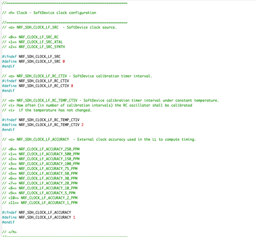

  • Further info. On speculation that the 32 KHz clock could be a problem, I tried the other selections for LFCLK.
    Set to 2 (synthesized from the 64 MHz clock) the behavior is identical. If started via drag&drop, it runs fine; started via F5 or power cycle it gets stuck in a reset loop in sd_softdevice_enable().
    Set to 0 (RC clock) it fails to start up under any conditions, presumably because the required external components are not present.
    So, if the 32 KHz oscillator is off the hook, what other minor ("trivial") difference could cause the behavior I'm seeing?

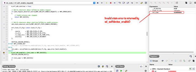

  • The observations you have described do not indicate an LF clock issue. If I have understood you correctly, these are the three problems you have observed:
    1. Failure in advertising_init() with NRF_ERROR_NO_MEM.
    2. NRF_ERROR_INVALID_STATE returned from sd_softdevice_enable() (again, this is expected on the first run when using Build & Run, unless you still have my run_reset_handler_once() test function at the start of main()).
    3. A sudden reset with an unconfirmed reset source occurring somewhere in ble_stack_init().
    However, it is unclear to me under which conditions these issues occur and when they do not. To find the root cause and narrow down the problem, we first need to understand exactly what the error is.
    If you still want to test with the LF RC oscillator, you can remove the test code you posted, and instead apply the following changes to the Softdevice clock configuration in sdk_config.h:

    Back to the issue at hand. Only item 3 above is still a problem. If I program with drag&drop, everything runs fine. But even after programming that way and later power cycling, the system appears to reset when sd_softdevice_enable() is called from within nrf_sdh_enable_request() which is called from ble_stack_init() which is called early in main(). So what is different about the way it resets from drag&drop programming vs. how reset works from power up?

    Also, it can be problematic to start the oscillator with one source and then have the softdevice select a different source in sd_softdevice_enable(). That was the reasonI suggested removing your test code and instead test with different softdevice clock configurations in my previous reply.
    I can't think of any relevant differences here and I think we are really missing enough concrete information about the failure to make meaningful guesses. It would be better if we could first confirm what is actually failing after a cold boot. Perhaps it could be that the external memory fails to get ready in time after a power up.
    You could try adding a few endless loops at different points in main() and do some test iterations where you remove the loop one by one down until you find the point it is no longer reached or start going in a boot loop.
        CRITICAL_REGION_ENTER();
    #ifdef ANT_LICENSE_KEY
        ret_code = sd_softdevice_enable(&clock_lf_cfg, app_error_fault_handler, ANT_LICENSE_KEY);
    #else
        ret_code = sd_softdevice_enable(&clock_lf_cfg, app_error_fault_handler);
        if(ret_code != NRF_SUCCESS)
            for(;;);

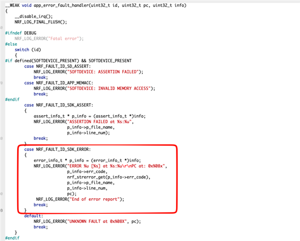

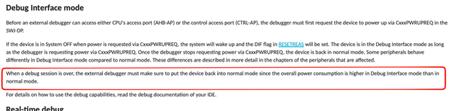

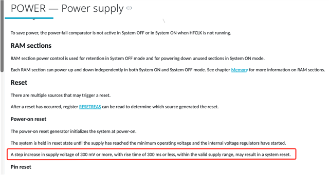

  • It sounds like this reset may occur even if you only have a busy wait loop in main(), which does point to a HW problem if true. We should try to confirm the reset source. To do that, please remove the part of your code that clears RESETREAS as suggested earlier, and instead read the RESETREAS value directly using your debugger. This avoids relying on the application to capture and store the register value correctly. You can use nrfjprog or nrfutil from the command line to read out the register after the reset has occurred.
    # Read out POWER->RESETREAS
    nrfjprog --memrd 0x40000400
    nrfutil device read --address 0x40000400 --direct
    Regarding the build code difference, please have a look at the PCN here: https://nrfconnectdocs.nordicsemi.com/pdf/PCN/pcn_106_v1.0.pdf. It's the same silicon. It's just that it's tested and assembled at different locations.
  • That's no help because the reset doesn't occur if run with the debugger. I already record RESETREAS into NV memory right at hte beginning of main(), and it's all zeroes in the failure case. ?!?!?
