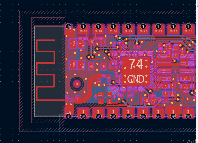

I am designing a custom PCB using the nRF52840 and a PCB trace antenna for 2.4 GHz BLE.
In my current design:
I will take nRF52840 dongle antenna design, impedance matching circuit and LC filter without any changes.
I have attached a screenshot of my RF layout showing:
  • nRF52840 RF pin
  • Matching network components
  • RF trace routing
  • PCB antenna feed trace

    The antenna can be of course reused. It it a generic PILA design for the 2.4GHz bands. All of the chips you listed use this frequency band, so the antenna is good for these. (For our other products, like the nRF9151, you would need completely different antennas.)

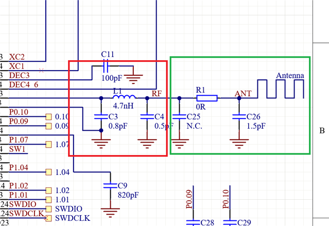

    Regarding the matching network, there are actually two of this, as you see in the schematic below. One is specific to this antenna (green) and the other is specific for the chip (red).
    The matching for the chip is specific to the IC. The schematic, the component values and sizes, and the layout must follow the reference for the corresponding chip. These components are placed close to the chip.
    The antenna matching is however there to tune the antenna. Here, there is a mounting option for a pi network, but only a shunt capacitor is used, which is usually enough to tune this kind of antenna design. These components must be placed close to the antenna. The antenna's and the chip's matching network is connected by a 50 Ohm impedance controlled transmission line (labeled "RF" here).
    Please note, that if your custom PCB size is different than the dongle, then the antenna tuning might need to be adjusted. This is usually done by changing the capacitor value (C26), and/or by adjusting the trace length of the antenna. Nordic offers this tuning as a free service for our customers.

    2. The matching for the chip must be always corresponding to the Reference Layout. The antenna matching (usually just one capacitor) depends on the PCB geometry.

    1. If I keep the same antenna design and the same MCU section, but reduce the overall PCB size, will the antenna still require retuning?
    For example, if the antenna geometry, matching components, and RF trace remain unchanged, but the PCB dimensions become smaller than the original nRF52840 Dongle board, how much impact can this have on antenna performance?
    Since I do not have RF test equipment such as a VNA or spectrum analyzer, how can I determine whether tuning is required? Is there any recommended design approach to minimize the need for retuning while maintaining 2.4 GHz operation and a 50 Ω transmission line?

    1, If you reduce the PCB size significantly (i.e. by 10-15% at least), then there is a possibility that the antenna will need to be retuned. As I said, we offer to do the antenna tuning for you (you have to ship some devices to our office).
    You can check the antenna performance by comparing your custom board to the dongle. Put another device 20-30 m away from the the dongle, and measure the RSSI. Repeat in the same setup with your design. If the difference is significantly lower, then the antenna is probably not optimal.
