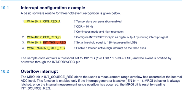

To configure a trigger mode i applied this configuration as say in the datasheet but no respone ::
Thank you.

    Regarding the threshold trigger, I actually made some modifications to the driver. I configured the `INT_CTRL` register as well as the threshold registers (`INT_THS_L` and `INT_THS_H`). I also configured the relevant settings in `CFG_REG_C` so that the interrupt pin would be used for threshold interrupts instead of data-ready notifications.
    I based this configuration on the official LIS2MDL datasheet, which states that enabling and configuring these registers should allow the threshold interrupt to be triggered.

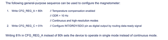

    For the DRDY configuration, I programmed the registers as shown in the screenshot below.
    Could you please let me know if there is anything else I should verify or if I may be missing a required configuration step?
    For the case DRDY ::
    INT_CTRL_REG  for the case of DRDY : 0x75

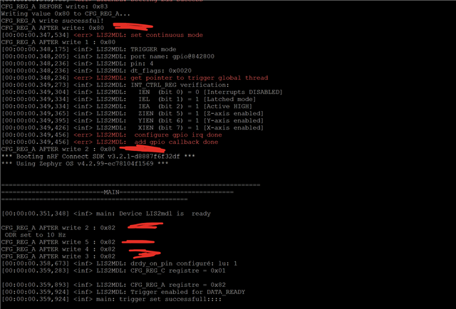

    I also noticed another behavior that may be related to the issue.
    When I configure CFG_Register_A, I write the value 0x80 (Continuous Mode). However, after the sensor initialization function completes(lis2msl_init), reading back the register returns 0x82 instead of 0x80, even though there is no function in my code that intentionally modifies this register.
    In the screenshot, I highlighted the register values with different colors to track when and where the value changes. I checked the register at several points during execution: before entering main(), during the sensor initialization function, and after initialization. The value appears to change unexpectedly.
    You may also notice some "read" messages highlighted in red in the screenshot. These are only debug print messages that I colored for visibility; they are not error messages.
    Could you clarify whether the sensor might automatically set bit 1 of CFG_Register_A, or if there is another mechanism that could explain why the register changes from 0x80 to 0x82?

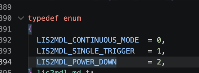

  • Why do you have this set to 0x82, 0x02 in that number means POWER_DOWN
    The only place that is written to that sensor is in lis2mdl_pm_action
    Seems like CONFIG_PM_DEVICE in your prj.conf is making this sensor go to low power mode by default. Try disabling CONFIG_PM_DEVICE andCONFIG_PM_DEVICE_RUNTIME just to test and see.
  • Also  INT_CTRL is the threshold-interrupt control register, it is not used for data-ready at all. Data-ready is routed only by the DRDY-on-pin bit in CFG_REG_C, which you already have set. So for the DRDY test you can ignore INT_CTRL.
  • So , when i did as you said , when there will be a New data(xyz)  , the interruptions pin drdy  triggered ......
    As well as ; i dont understand why when i configure the reg_A to take 0x80 , it takes and the value of reg_A displays 0x80 but when they finish the initialisation (lis2mdl_init)  it takes the default value 0x82

    Good, so now you have a working system. As I mentioned in earlier reply, the CONFIG_PM is making the sensor go to sleep immediately, that is because the driver of that sensor have implemented the powre management and you have enabled that power management in your prj.conf. As to why the driver decides to do that is the question you need to ask in Zephyr forums and/or that sensor manufacturer. You can easily override it (like you just did) if you need. You can also enable those configs and change the behavior of the pm_action calls as your application requires.
