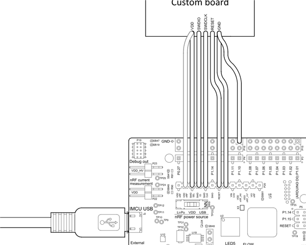

I am developing a custom PCB based on the nRF52840 and am currently trying to flash/debug it using an nRF52840-DK (PCA10056) as an external debugger.
connected devices like this without the custom board:
So how do I connect the custom board when I have made testpads for vdd, gnd, swdio, swdclk. No testpad for nReset and no way to get to it anymore.
im seeing in the pca10056 3.0.3 p20 where are connections to
pin 1: VDD_nRF
pin 2: VDD_nRF
pin 3: SWD SEL
pin 4: SWD IO
pin 5: SWD CLK
pin 6: SWO
pin 7: RESET
pin 8: empty
pin 9: VIN 3-5V
pin 10: VDD nRF_HV
pin 11: VDD nRF_HV
pin 12: VIO REF
pin 13: empty
And which way the all switches needs to be?

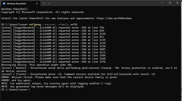

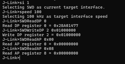

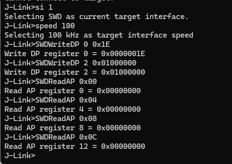

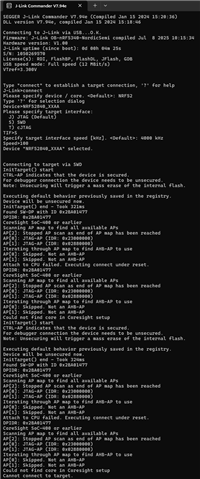

    • The chip has never been successfully programmed.
    • SWD communication is present. J-Link consistently detects the SW-DP (ID 0x2BA01477) and the CTRL-AP.
    • However, the AHB-AP/core is never accessible. J-Link reports “Could not find core in Coresight setup,” and both nrfutil device recover and nrfjprog --recover fail because the access port remains protected after erase and reset.
    • I have tested with both an nRF52840-DK (PCA10056) and an nRF51-DK (PCA10040) as external debuggers, with identical results.

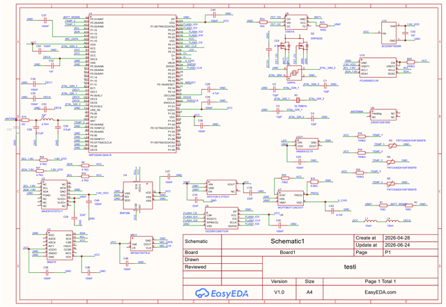

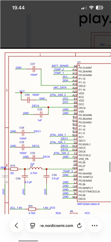

    And can you confirm if these gnd connections are critical errors that are keeping the access to the chip impossible (photo):
    For example DEC5, P0.30, P0.10 exc.
    Thank you for your help.

    lassey0 said:
    Also, based on the schematic and these symptoms, do you see anything that could explain why the device appears protected before it has ever been programmed? Or does this behavior suggest a hardware issue with the board or the MCU itself rather than the missing nRESET connection?
    I am not too sure about what is happening here... After further checking of the hardware, I can indeed see some issues with the schematic. I am not sure if they are the root of your problem, but they definitely need to be fixed.
    The main errors that I could see are:
    • DEC4 <---> DEC6: They should be connected together (link).
    • DEC5:  currently connected to GND, but should be left floating (link).
    • (minor) Leave the unused GPIO pin floating, and it is a good practice to still expose them if you have the space on your PCB.
    But please remember that I am not a hardware engineer, so please take it with a grain of salt.
    Also, have you made some voltage measurements on your board? Can you please check if the power supply is managing to output a stable voltage?
    And are the decoupling capacitors close enough to the nRF52840?
