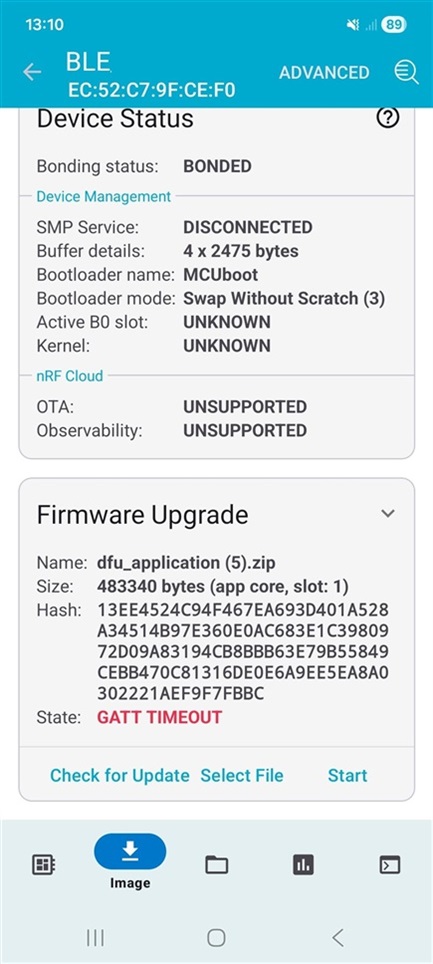

    But now I'm having an issue with the Device Manager mobile app—when I select "Test and confirm" while uploading a new image, it displays "GATT TIMEOUT" (see attached screenshot), even though both the upload and image swap complete successfully.
    Do you happen to know what might be causing this? If I select "Confirm," shouldn't the new image be applied when uploading from both the computer and the mobile app without having to reset the DevKit using the button?

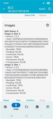

  • The new image has been successfully uploaded and swapped from both the PC (Auterm) and the mobile device (Device Manager), but I’m getting a “GATT TIMEOUT” error in the mobile app when I select “Test+Confirm.”
    I didn't perform a reset using the button; everything happened automatically.

    If I select "Confirm only" in the Device Manager mobile app when uploading an image, the process completes successfully and the app displays: "UPLOAD COMPLETE".
    It just seems strange to me that, at a different RTT terminal address (the application address), I still see the output from the old image without pressing the reset button, even though the new image is active in slot 0 in both Auterm and the mobile app. (verified by the change in the LED's flashing speed on the DevKit). If I then press the reset button, the RTT output is okay.

    Please clarify:
    - When doing DFU with "Test&Confirm" the DFU process still finish successfully. It's only that the app showing GATT TIMEOUT (This usually happens when the app can't connect to the application running the new image). Can you connect to the DUT after the image swapped ?
    - When doing DFU with "Confirm only" everything works fine (mobile app and the DUT) ?
    - RTT logging is stored in RAM, so there is a chance that the RAM area that store the RTT logging still have the old log from the old image and has not been cleared. If you print a new log every time you blink an LED do you see the old log or new log ?
    Yes, when performing a DFU using the "Test & Confirm" option, the DFU process still completes successfully. However, the "GATT TIMEOUT" message appears in the Device Manager mobile app. After flashing the new image, I can connect to the device (via both the mobile app and AuTerm).
    When performing DFU with the "Confirm only" option, everything works correctly - both the mobile app and the upload via AuTerm.
    After flashing and opening RTT without a reset, it will likely display some uncleared area because the firmware update actually takes place - for example, I tried changing the LED blink speed on the DevKit which actually changed after the OTA update. After resetting with the button, RTT now displays the output from the new version.
    Thanks

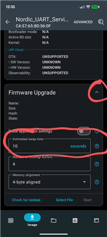

  • Hi Iot,
    Could you let me know a little bit more about the application ? The issue you have is most likely because it take too much time to reboot and swap image so the app on the phone tried to reconnect but unsuccessful and show the GATT TIMEOUT. But as you mentioned, it was advertising and possible to connect to after the new image booting up.
    I would suggest to try testing with very simple application so that the swapping time is shorter.
    If you develop  your own app, you can delay the reconnection time to give more time for the DUT to swap image and advertise.
  • Hi again,
    Please try to increase this timing to see if it help with the "Test&Confirm" DFU:
