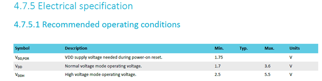

Can you provide more details about power variation? how much it varies? and what is the voltage mode you are using ? For High voltage mode you need at least 2.5 V for reliable operation. IS the voltage dropping below 2.5 V when you see lower TX power?

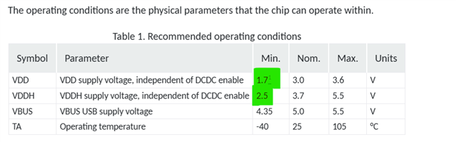

There is similar content in the nRF5340 datasheet, so I am sending you a screenshot.
voltage mode is normal voltage mode and dcdc mode.
3.3V is input to the VDD pin of all nRF5340. 3.3V dose not change.

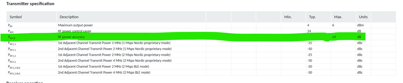

The Tx power variation is as follows:
It was observed that the power variation in the advertising channel decreased by up to 10dB at 100% and 20% battery levels. The measurement was performed by placing an IoT device inside a shield box and measuring the power.
BT power measurement is not conduction mode, but the radiated mode you mentioned.
