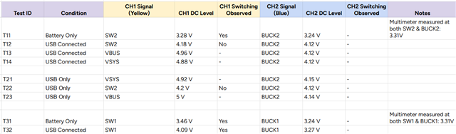

  • Dear Szabolcs,
    Thank you for the clarifications and debugging suggestions.
    Please find attached the oscilloscope measurements, along with a tabulated summary of the observations under both battery-only and VBUS-connected conditions.
    I would appreciate your review of the captured waveforms and measurements. Please let me know if there are any additional checks you would recommend.
    Thank you for your guidance.
    Scope Measurements.zip
