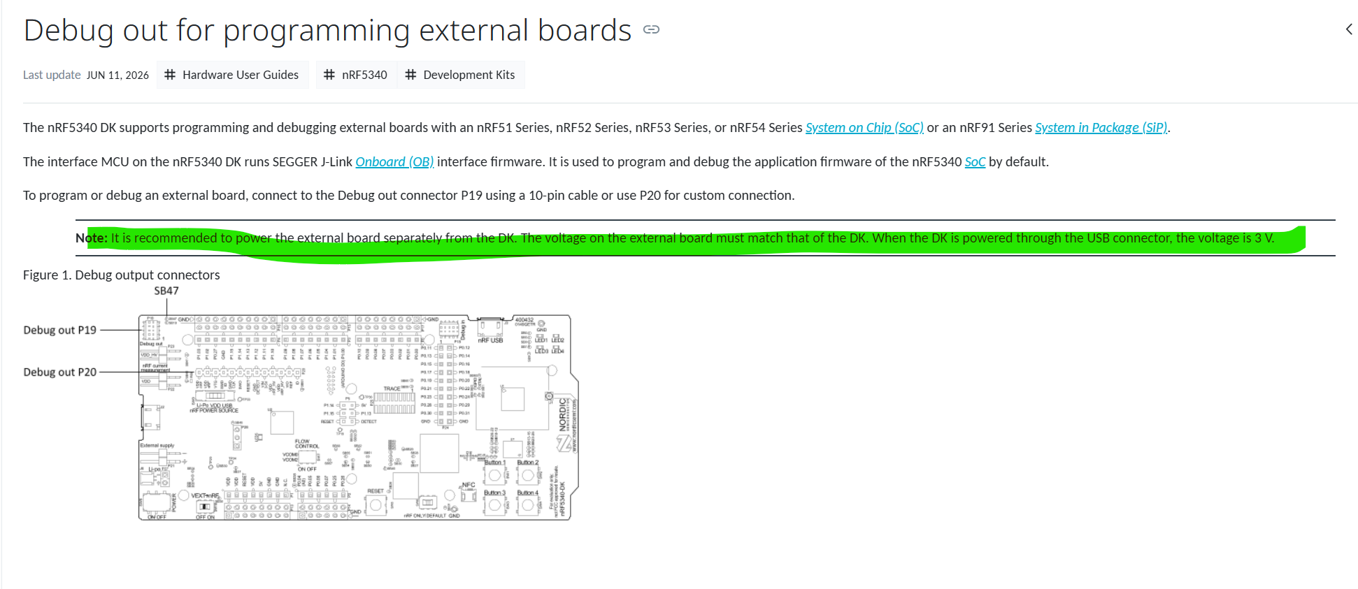

MDBT53V-1M: SWD Debug Port Inaccessible on Two Units - Possible Factory APPROTECT
I am writing regarding an issue I am experiencing with two MDBT53V-1M modules (nRF5340) that I have assembled on custom PCBs. Both modules exhibit identical behavior, which suggests a factory configuration issue rather than an assembly problem.

Connection: Standard 10-pin 1.27mm SWD cable, J2 (2x5 Cortex debug header) -> P19 on nRF5340-DK
Target power: 3.3V supplied independently
VTref measured: 3.300V

  • Hi Patricio,
    *Can you change the target device (custom board) voltage to 3 V instead of 3.3V and see if it helps.
    * Try to change clock speed for SWD to see if it helps :  nrfjprog  -c  <speed_in_kHz <other_command>
    nrfjprog commands • nRF Command Line Tools • Technical Documentation
    * Also since you are using 3rd party module, I strongly recommend to check with them (contact Raytac) to see whether MDBT53V-1M modules ship with APPROTECT and/or ERASEPROTECT enabled, and whether a factory unlock procedure exists.
    * Also check ERASEPROTECT status by reading UICR.ERASEPROTECT (0x00FF8020) — if the value is not 0xFFFFFFFF, ERASEPROTECT is active.
