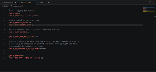

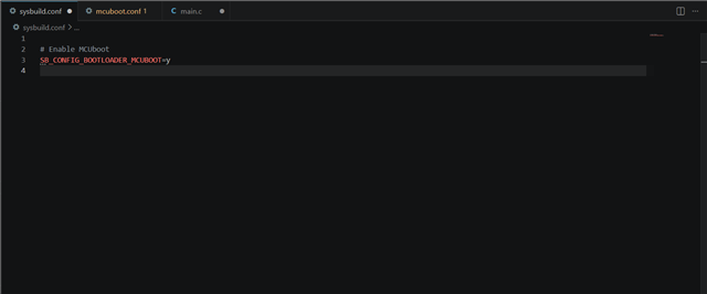

In nRF54L15 DK, I set "SB_CONFIG_BOOTLOADER_MCUBOOT=y" in file "sysbuild.conf".

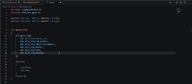

It makes main function GPIO toggle stop.
Do have any solution to prevent this problem?

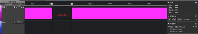

result:

Is the gap shown in your logic trace happening while the chip is starting up after a reset? The bootloader executes first at startup and is responsible for validating the application's signature before booting it. However, 10 us seems a little too short to complete this part of the boot sequence.
Vidar
Hi Vidar
The situation has no reset occur.
Austin
No, it is not a solution to keep the IRQs locked. It will prevent DFU and other tasks from being performed. Maybe you can say a bit more about what you are trying to achieve and what your requirements are.
