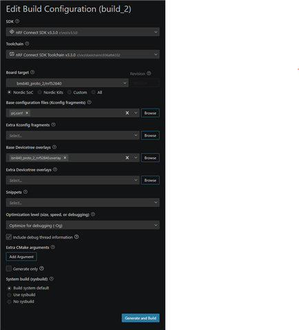

  • Hi Carl,
    Here is a screen shot of the build_2 build configuration in question:

    Doing a Manage toolchains > Validate toolchain pops up: "No issues were detected with the toolchain."
    All the logging in a pristine build reference v3.3.0.
    All that seems as expected.  What else can I check for us?  Where is the configuration for nRF Util vs. nrfjprog?

  • Hello again!
    Thanks for the details. Are the board files of your custom board perhaps migrated from an older version of the SDK? If so, nrfjprog may still be specified as runner in the boards.cmake for your board file. If you take a look at any of the existing board files for Nordic devices in the SDK you can use those as a reference.
    There are more details about runner selection here.
    Carl RIchard
  • Yes, this was the problem.  All that needed to be done was to change the order of the include(${ZEPHYR_BASE}/boards/common/nrfutil.board.cmake) line in the board.cmake file to be the first of the set of include statements.
