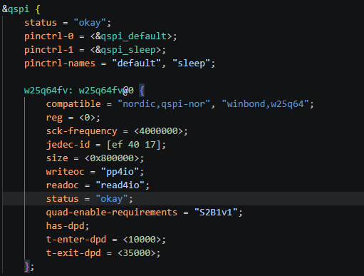

I have a customized nRF52840 board with an external NOR Flash (W25Q64FV), and I have some confusion when conducting read and write data testing.

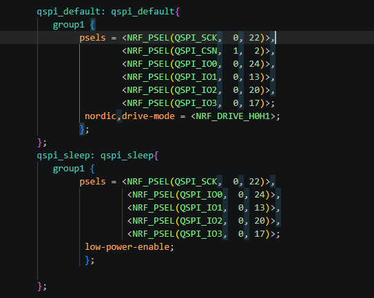

This is my device tree configuration:
This is my test code:

Then add to the device tree:

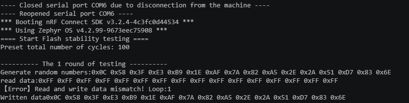

writeoc = “pp4io”;
readoc = “read4io”;
When Quad SPI is enabled, all data outputs are 0xFF, as shown in the figure
fter annotation, all read and write data are normal.
I think it is: Four link activation requirement="S2B1v1"; Not working (QE) or
other reasons.Also, can you give me some suggestions on whether my device tree
configuration is normal and whether there are any issues with the code
