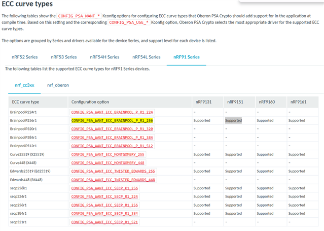

  • Hi Achim,
    is it possible to use ECC_BRAINPOOL_P_R1_256 with NCS 3.4.0 PSA?
    Yes, see ECC curve types
    I cannot reproduce with the nrf/samples/crypto/ecdsa by
    replacing secp256r1 with CONFIG_PSA_WANT_ECC_BRAINPOOL_P_R1_256=y in prj.conf;
    using PSA_ECC_FAMILY_BRAINPOOL_P_R1 for key generation + import;
    Unchanged boards/nrf9151dk_nrf9151_ns.conf (already has CONFIG_PSA_CRYPTO_DRIVER_CC3XX=y).
    You can verify the Kconfig symbols in build/app_name/zephyr/.config:
    • CONFIG_PSA_CRYPTO_DRIVER_CC3XX=y
    • CONFIG_PSA_WANT_ECC_BRAINPOOL_P_R1_256=y
    • CONFIG_PSA_ACCEL_KEY_TYPE_ECC_PUBLIC_KEY_BRAINPOOL_P_R1_256=y
    • CONFIG_PSA_NEED_CC3XX_ECDSA_BRAINPOOL_P_R1_256=y
    • CONFIG_PSA_NEED_CC3XX_KEY_TYPE_ECC_WEIERSTRASS=y
    Here is my test project: ecdsa-brainpool-verify.7z
    “Beware that this code/configuration is not fully tested or qualified and should be considered provided “as-is”. Please test it with your application and let me know if you find any issues.”
    Amanda H.
