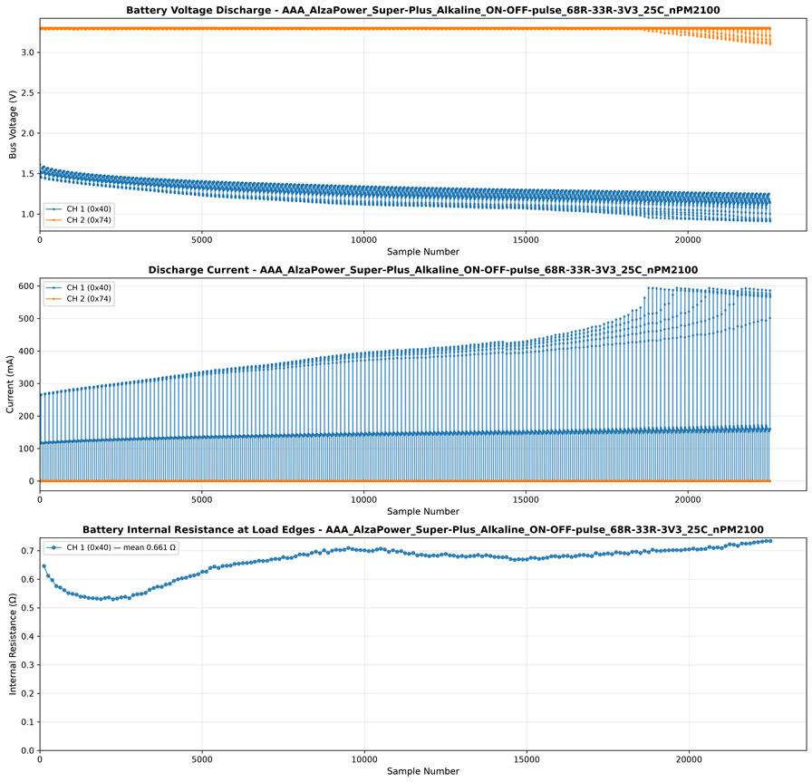

We use the nPM2100 EK for getting familiar with nPM2100 for its potential use in our project where we aim to use single AAA battery for powering it.
Our usage profile is simulated in the measurement attached below, where:
  • top chart represents output voltage ~3.3V and input voltage (AAA battery)
  • middle chart represents current drawn from the battery
  • bottom chart represents an approximated AAA battery internal resistance (rough estimate - it shouldn't be compared to standard DS values)
Long story short, the battery is periodically loaded with ~50mA @ VOUT (~3.3V) - 1minute ON, 1 minute OFF. During the ON state, in the middle, the load is increased (for 5s) to ~100mA @ VOUT (~3.3V) which is the maximum we expect to draw from the battery.
We test when the output voltage drops below the desired 3.3V level which happens at the end of the measurement. At this state, the output voltage drops and the battery current increases.
Question:
Could you advise why the measured battery current saturates ~600mA when we have the IBALIM set to 800mA?
IMHO:
  • In case the bottleneck was the battery, its voltage would drop further, right? It doesn't do that.
  • The inductor selected inside the EK seems to have good saturation current rating.
We also used the default config of 600mA, the measured values were lower ~540mA.
Our measurement is performed with INA228 with 0.1Ohm shunt resistor, ~1 sample/second. It's quite under sampled. On the other hand, since IBATLIM is "Battery (valley) current limit setting", I believe the 800mA we set is actually the threshold when the ON state is re-activated again (the inductor gets charged again). So the average value would be higher than this level BUT it's lower...
Thank you!
    It could be the case that the voltage would drop further, but we should verify. We'll be able to test this on our end after the weekend, but you may be able to test this yourself like this:
    Use a voltage supply that can deliver well above 800mA instead of the battery for testing. Then, when you hit the current saturation you will know for certain that it's the nPM2100 limiting the current.
    If the saturation current is still far from what's selected in IBATLIM, we can investigate further internally.
    Also worth noting, but not necessarily a limiting factor for the current, is that at the end of your sequence, you reach 600/3.3 ~180 mA on VOUT, which exceeds the value for IVOUT_MAX (150mA) documented in the boost electrical specification. Please keep this and other maximum operational boundaries in mind going forward.

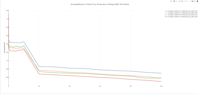

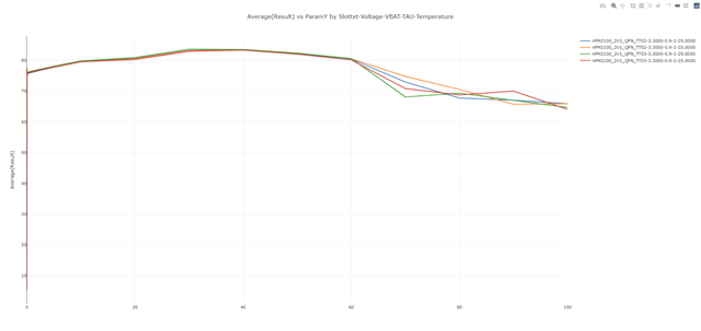

  • Hi Jiri,
    Jiri B. said:
    The suggested test with stabilized laboratory power supply is very good hint. We will try that as soon as we have a chance.
    One of our PMIC devs performed this test with the results below. I'm sharing them so you can compare your findings with ours.
    The IBAT is limited as expected when supplied from a power analyser. On the highest IBATLIM setting (800mA), the VOUT starts collapsing seemingly before that limit is reached, but the PMIC remains operational until that limit with lower VOUT. Exceeding any set limit eventually leads to brown-out.
    Conclusion: the limit appears to be accurate.
    Comment: The observed VOUT collapse may be due to pushing IBAT high and exceeding the boost output rating of 150mA.
    Regarding your positive feedback observations, I have shared this with the team to take a look at.
