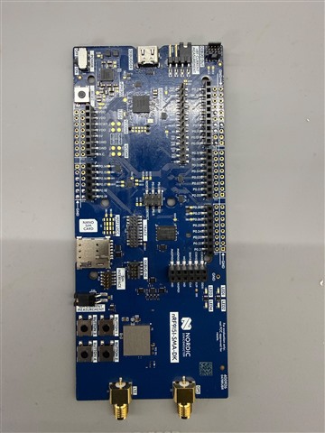

I've hit a wall with my nRF9151 SMA DK (board S/N: 1052077972) and I could use some help.

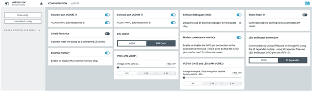

    There are two things I would like you to double-check.
    * First is the board controller settings, which can be viewed in nRF Connect for desktop -> Board Configurator, to ensure "Software Debugger" is enabled:
    If that is checked, then it could be that the firmware is asserting early on in the boot-up process. This makes it hard for the debugger to attach properly.

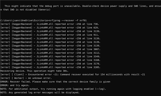

    * To recover a "tough to recover" board, one can use a nrfutil / nrfjprog recovery loop script:
    :loop
    nrfutil device recover
    goto loop

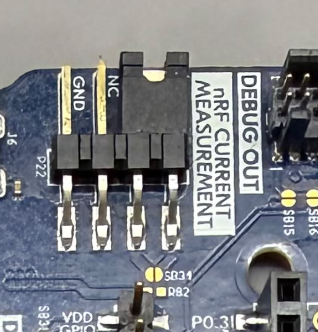

    Save this as "nrfutil_recovery.bat" and run it. While the script is running remove and attach this jumper continuously until nrfutil reports a "success":
    After approx. 5-30 jumper attachments, nrfutil should report a success:
    ✔️ Recovered 1050910090
    Please let me know if you still have issues.

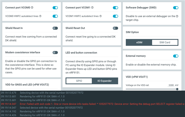

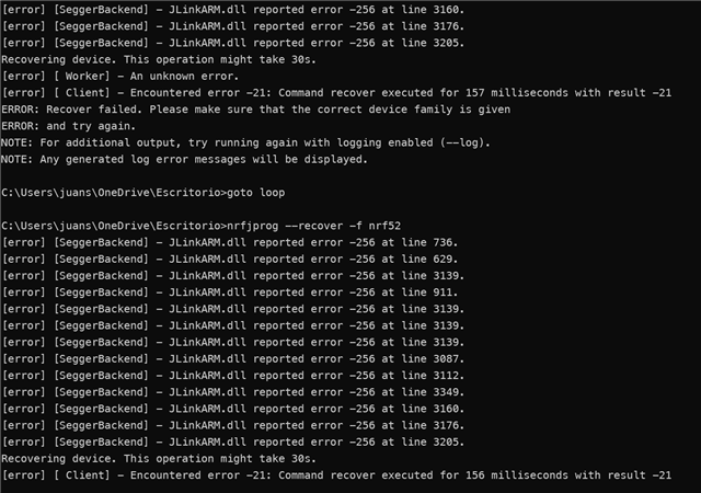

  • Thank you for your quick response.
    I've been trying for quite a while, but unfortunately it hasn't recovered.
