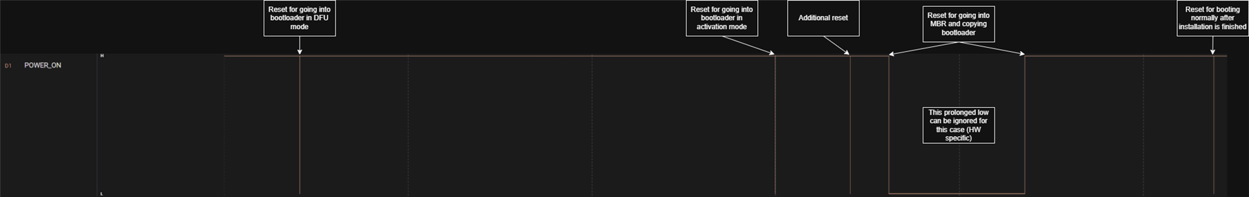

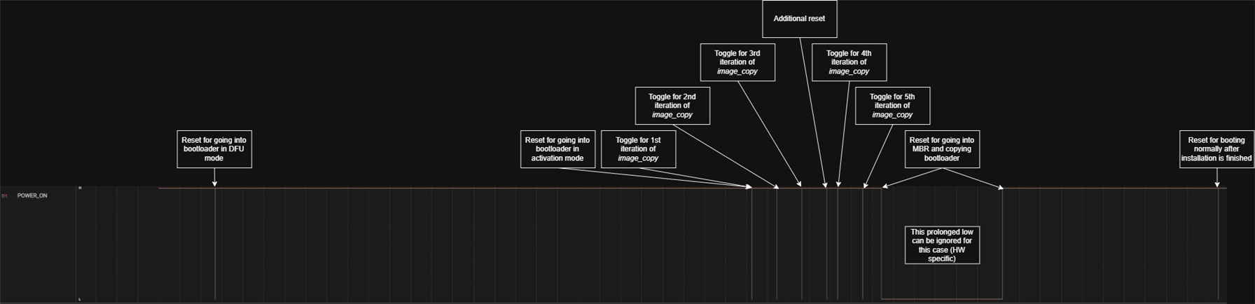

In the described scenarios there's going to be 3 and 4 resets respectively for the installation to complete. However, from my testing I'm consistently seeing 1 additional reset in both scenarios. The additional reset happens during the image_copy function in nrf_bootloader_fw_activation.c (which is called when copying the new application image and when copying the new SoftDevice image). The additional reset happens consistently, and in the same place. The image_copy function is called with arguments that at most allows it to copy 8*4KiB=32KiB at a time, and it's during the 4th of these copies (the 4th iteration of the while-loop in the function) that the reset happens. In both cases the MCU reset an additional time and continues the copying and finishes the whole installation process.
Below are some Saleae captures I hope help illustrate what I'm seeing. The signal POWER_ON indicates MCU resets, with it going low meaning the MCU reset and it going high meaning the bootloader has started running. I've then added additional toggling of the same signal to indicate loops in image_copy.
  • Base capture without additional toggling of POWER_ON
  • Capture with additional toggling of POWER_ON
It's not visible in the captures, but I can tell the difference between my toggles and MCU resets by how long POWER_ON stays low (my toggles holds POWER_ON low for 300ns while MCU resets holds it low for 700us).
I've tried moving the extra toggling of POWER_ON to after the other function calls in image_copy (nrf_dfu_flash_erase, nrf_dfu_flash_store and nrf_dfu_settings_write_and_backup), but I see the same number of toggles and the behavior is still present. To me this means it's not one of the functions failing. In image_copy there's this line:

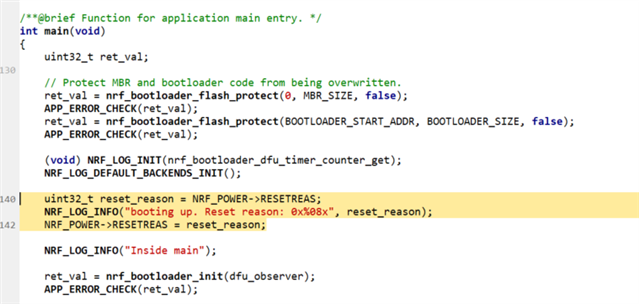

    If you are using an IDE (Keil/Segger Embedded Studio/IAR), then this are settings in the IDE's project settings, but you should be able to use the flash start address and length similar to the ones in the _debug project. Then you should be able to enable logging in the bootloader. Try doing this, enable logging in your bootloader, and see if you can see what is going on without modifying anything else. If that doesn't tell us what is happening, try to add this to the beginning of the bootloader's main() function:
        uint32_t reset_reason = NRF_POWER->RESETREAS;
        NRF_LOG_INFO("booting up. Reset reason: %08x", reset_reason);
        NRF_POWER->RESETREAS = reset_reason;
    Like this:
    This should print something like "booting up. Reset reason 0x00000001"

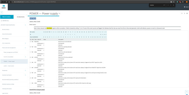

    Then compare the reset reason to the reset reason register:
    (Source)
    What are the causes of the resets? We would expect it to be mostly SREQ (0x00000100), but are one of them from e.g. "DOG" (0x00000010)?
