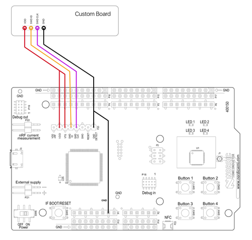

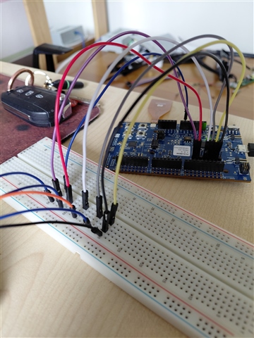

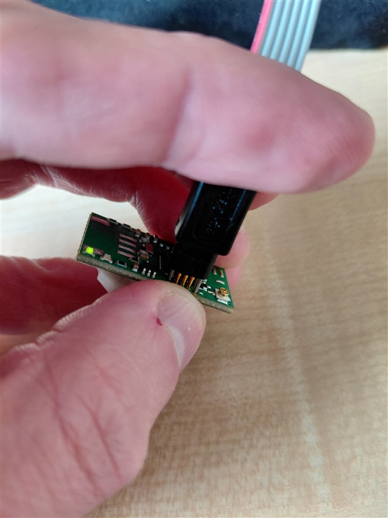

I'm trying to flash and debug an nrf52832 on an external board using an nrf52 dk. I have set up my wiring from P20 to a tag-connect TC2030 6-pin needle based on this diagram:

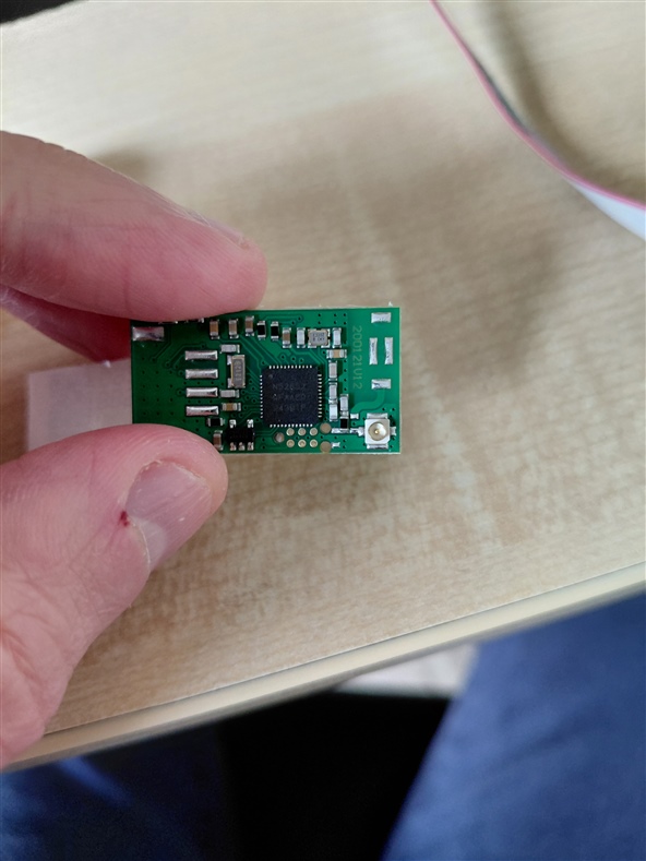

and assuming that the 6 connectors on the external board are laid out in the following way (viewed from above the board):
I've tried a variant where the external board gets its own power at 3v and that didn't work. I've been trying the option where the external board gets its power from the dev kit, however neither setup is working for me.

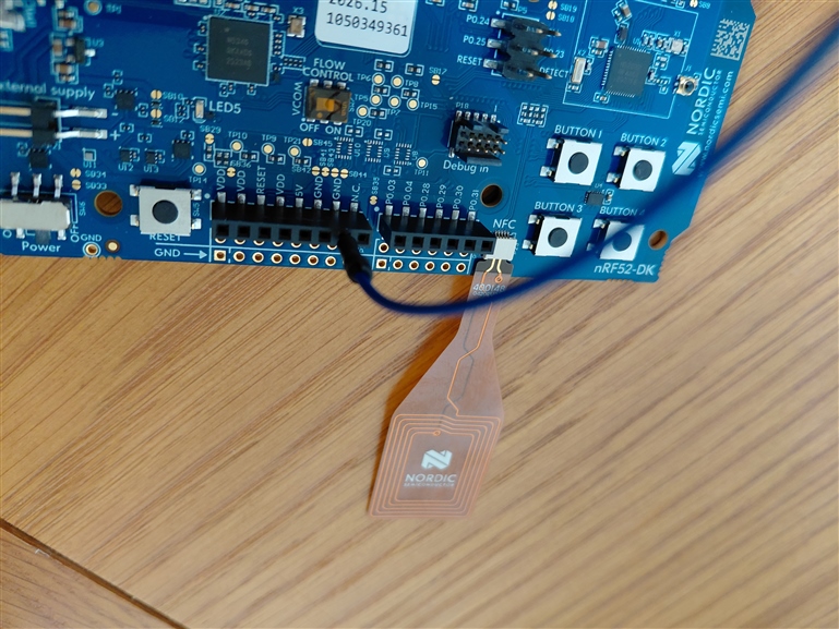

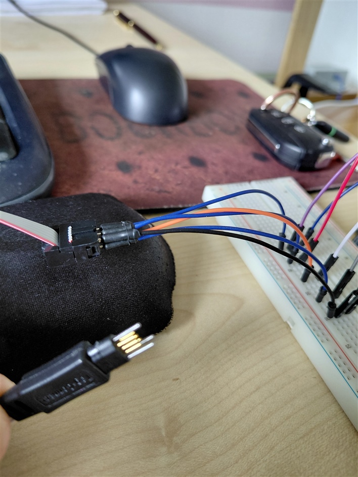

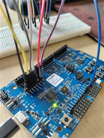

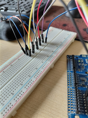

Here are some pictures of my wiring. Note that in this setup I'm also using the reset connection but with or without that connection I haven't been able to get it to work:
I've used a multimeter to confirm that the 6-pin needle pins have connectivity to the header via the correct routes. I.e. SWDIO -> SWDIO, SWDCLK -> SWDCLK etc..
I've also confirmed that my 6-pin needle is outputing a steady 2.98v between VDD and GND. When I attach the 6-pin needle my external board lights up and I have a flashing LED so I know it's getting power from the needle.
After some failures, I updated J-Link to the latest version 9.68a and I've updated my nrf52 dev kit to the latest firmware, but still no luck.
I believe the connection between my PC and the dev kit is fine as I've been able to flash and debug with it without any problems for the last few days and if I remove my wiring, it still works fine.

  • Hi All.
    I've reverse engineered another nrf52 dev kit which I know works with the particular external board I've got and I've now solved my issue.
    As mentioned before, I was assuming a 6-pin SWD mapping like I've seen documented in multiple places. Like this:
    Pin 1 -> VT ref
    Pin 2 -> SWDIO
    Pin 3 -> nRESET
    Pin 4 -> SWCLK
    Pin 5 -> GND
    Pin 6 -> SWO
    However, for whatever reason, the person who designed this particular external board decided to map the 6-pin contacts like this:
    Pin 1 -> VT ref
    Pin 3 -> GND
    Pin 5 -> SWDIO
    Pin 6 -> SWCLK
    So the issue wasn't my nrf52 dk or my wiring or my J-Link software, but it was due to an unconventional layout of the 6 contacts. Once I rewired my board I was able to connect to it with J-Link Commander successfully first time. Even with the long cables and the breadboard I was able to connect using 4000 kHz so all is good.
    Thank you Turbo J for your time and suggestions.
    Mike
