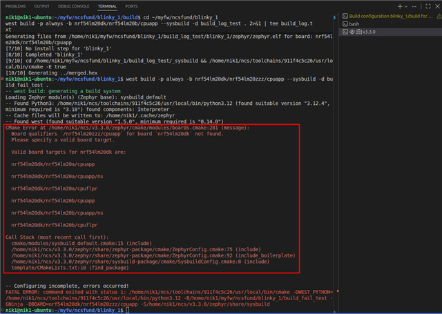

    FATAL ERROR: command exited with status 1: 'C:\ncs\toolchains\936afb6332\opt\bin\cmake.EXE' -DWEST_PYTHON=C:/ncs/toolchains/936afb6332/opt/bin/python.exe '-Bd:\Active\firealarm\firealarm\build_1' -GNinja -DBOARD=nrf54lm20dk/nrf54lm20b/cpuapp -DCONFIG_DEBUG_THREAD_INFO=y '-SC:\ncs\v3.3.0\zephyr\share\sysbuild'

    I am currently trying to reproduce the error on my end. In the meantime, could you check the build output in the nRF Connect terminal? Specifically, I would like to know whether you see a line beginning with "CMake Error at" and a "Call Stack (most recent call first):" block above the two lines you sent me. The image below shows what this looks like on my setup.

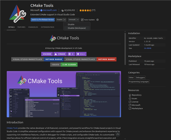

    Do you have "CMake tools" from microsoft enabled as extension? If you do, can you try to disable it? Click on disable (workspace) as shown in the screenshot below. Close and reopen VScode, then remove all build folders under "d:\Active\firealarm\firealarm\". Then create the build configuration and build again.
