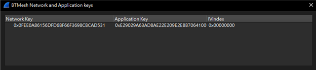

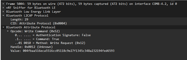

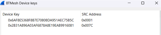

Can nRF Sniffer do Bluetooth Mesh packet decryption?

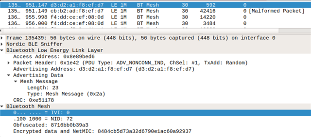

From this old thread, nRF Sniffer seems can decrypt the mesh packet.
 Sniffing Bluetooth Mesh packets
But I still failed with add network key, application key, device key and IV index.
I attach the wireshark capture file for reference.
mesh_light_ctrl_260826.pcapng
And also nRF Mesh APP export JSON file.
