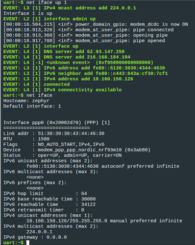

    My log stops here:
    uart:~$ > net iface up 1
    net iface up 1
    EVENT: L3 [1] IPv4 mcast address add 224.0.0.1
    Interface 1 is up
    EVENT: L2 [1] interface admin up
    [00:00:47.386,893] <inf> power_domain_gpio: modem_dcdc is now ON
    Marco

    I think I found the reason. the nRF93 module had a preset APN inside "pepper" (seems to be the one from Things Mobile).
    After I deleted the apn with AT+CGDCONT=1, it then got the APN automatically from network.
    In our applications, it is important to have the APN given from network auotmatically.
    Marco
