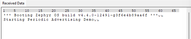

I get the following output:
*** Booting Zephyr OS build v4.4.0-6649-gc74133ec989e ***
Starting Periodic Advertising Demo
[00:00:00.503,906] <err> bt_driver: IRQ pin did not raise
[00:00:00.503,936] <err> bt_driver: Error -5
[00:00:00.503,936] <err> bt_hci_core: Unable to send to driver (err -5)
[00:00:00.504,028] <wrn> bt_hci_core: opcode 0x1003 status 0x1f Bluetooth init failed (err -5)

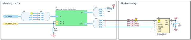

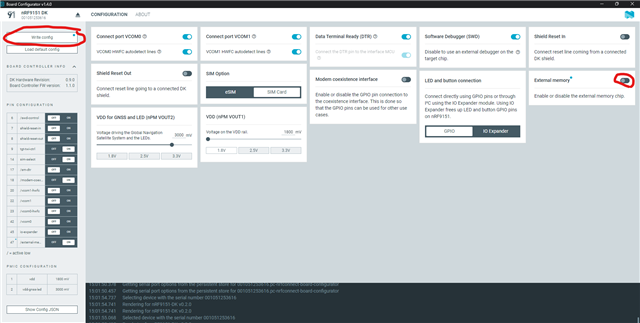

    If you look at the back of the DK, you can see that pins P0.11-13 is connected to the external flash chip on the DK, and not to the pinout. If you want to route these pins out to the pin headers, you need to use the nRF Connect for Desktop -> Board Configurator, and then disable the external flash:
  • I disabled... or... ¿enabled? it.
    No change in behaviour.
    It's a bit confusing, that the entry (47) in the pin configuration table is the inverse of the switch at the right side of the GUI.
    If I send dummy data over the SPI, I can see the data on the MOSI pin on the x_nucleo_wba25a1_spi expansion board, regardless of the external memory interface setting. So the data at least arrives at the arduino expansion header.
    Which if I understand correctly according to you should not actually happen if the memory interface is set "incorrectly"?

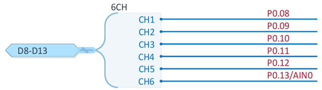

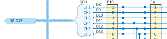

    Checking the schematic PCA10171_Schematic_And_PCB.pdf
    Sheet 2, Section 6,7 C
    Sheet 7, Section 1,2,3 C
    Pins P0.08 to P0.13 seems to be directly connected to the arduino expansion header.
    The switch only seems to disconnect the memory itself.
    Sheet 6
    Yes, that is because I didn't write the config yet in that screenshot by clicking the circled "write config" in the upper left corner.
    If it is not properly disconnected, some of the pins may be connected to the external memory, pulling some of them high or low, making them uncontrollable for the nRF91.

  • Oh, in my version it toggles in real time and stays inverted after writing and reading back.
    This seems to be correct, since the entry in the table starts with / which I would interpret to mean inverted.

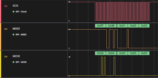

    No, the bytes on wire are the header transaction of the zephyrs HCI over SPI protocol.
    MOSI
    0x0A - WRITE
    0x0004 - Tell wba25 to expect a 4 byte command
    0x0000 - ¿Reserved?
    MISO
    0xFF - State unknown / not configured
    0x013B - Slave reports 315 bytes of (free) buffer
    0x0000 - Bytes waiting to be transmitted
    Actually at this point, the next transaction should be for the nrf9151 to send
    0x01 0x03 0x10 0x00 - RESET COMMAND
    On the nRF9151-DK, the RESET command does not seem to be send.
    On the nRF52-DK, that is exactly what happens.
