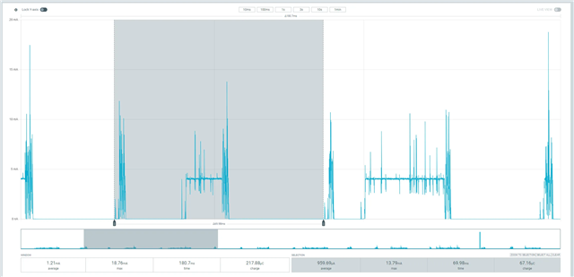

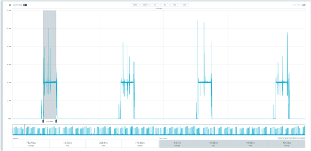

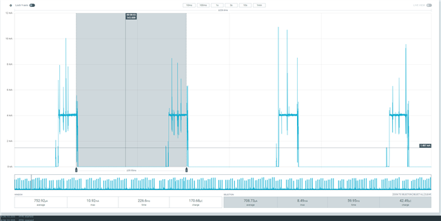

Problem Description:

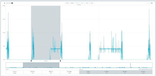

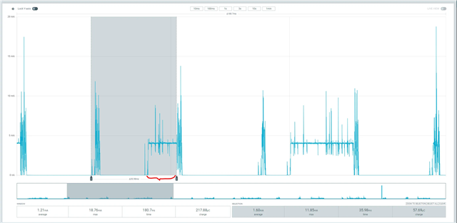

I am running a dual-role application (Advertiser + Scanner). When monitoring power consumption, I observe that the Scanner RX window (approx. 4-5mA) starts, but gets abruptly truncated by TX spikes (approx. 15mA) around the 15ms mark. The scanner window does not resume after the TX spike; instead, it waits for the next scan interval. The interruption appears to be caused by the Advertiser's TX activity, which may be either an advertising event or a connection event (if a central device has connected to us, with a 60 ms connection interval).
[Please see the attached power profiler waveform showing the interruption]
Questions:

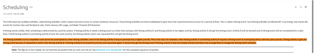

  1. The documentation states: "The timing-activities run to completion and cannot be preempted by other timing-activities, even if the timing-activity trying to preempt has a higher priority." However, my power profiler waveform shows that the Scanner RX window (approx. 4-5mA) has already been running for ~15ms when it gets abruptly truncated by the Advertiser TX spikes (approx. 15mA). How does the SoftDevice Controller define "already started"? Is it at the moment the radio starts receiving, or at the moment the scheduler officially locks the radio resource? Why does an event that appears to have already started still get truncated?

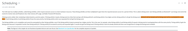

  2. The documentation states: "Activity B will be blocked and its timing-event will be rescheduled for a later time." However, in my observation, the Scanner window is not "blocked and rescheduled" — it is directly terminated, and the remaining 15ms is discarded. The scanner does not resume after the TX spike; it waits for the next scan interval. Does "rescheduled for a later time" mean the next scan interval (i.e., the entire window is discarded), or does it mean the remaining window time should be resumed?

    Please be aware that you are mixing different types of documentation and software. All the screenshots mentioning S140 is for the Softdevice S140 from the nRF5 SDK. This is not what you have running on your nRF54LM20A. This is your first and third screenshots. Your second screenshot, however, seems to be from the nRF Connect SDK (NCS) where the Softdevice Controller is being documented.
    However, after checking, the behavior is more or less the same. It says that the SoftDevice Controller from NCS also shouldn't stop already started events. This part is documented here:
    https://nrfconnectdocs.nordicsemi.com/ncs/latest/nrfxlib/softdevice_controller/doc/scheduling.html#scheduling
    Although, I am not sure exactly what I am looking at here. I asssume that throughout all this, you are using a scan interval of 60ms, and a scan window of 10ms. Also, it looks like you are using an advertising interval of 30ms.
    What I can't tell is e.g. from your 6th screenshot, what the length of the scan window is:
    To me it looks like roughly 10ms.

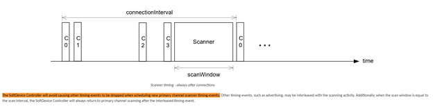

    However, from the changelog (present from v2.7.0) found in NCS v3.3.1\nrfxlib\softdevice_controller\CHANGELOG.rst, it says:
    * The |controller| will now schedule all scanner primary channel timing-events cooperatively even when the sum of the scan windows is less than the scan interval.
      If the |controller| is unable to schedule a full scan window for a long time, the scheduling priority will be raised to ensure a full window is scheduled.
      Generally, this change will result in either increased scanning time, or similar scanning time to before.
      In cases where there are many conflicting activities within the scan window, this change may result in reduced scanning time. (DRGN-19050)
    (Note that I was looking in the changelog from v3.4.0, but this has been present since v2.7.0).
    I would say that this explains what you are seeing. However, it does not explain that you are seeing constant 10ms scan windows in your first plot, but I am not sure you were using the same scan parameters there?
    I agree that the changelog makes the behavior different from the documentation, and perhaps the documentation should be updated. However, the change itself means that you will get more scan time than you would otherwise. Without that change, all the scan windows that would collide would be dropped completely. Now at least parts of it will be scheduled. Ideally, if you know that you will be advertising and scanning at the same time, you should try to set the scanning and advertising parameters so that they don't continuously overlap.
    You would think that setting both intervals to e.g. 60 and a scan window of 30 would be the best, but remember that a random delay of 0-10ms is added between each advertising interval, so the advertisements will drift. Hence, play around with the numbers until you find something that works for you.
