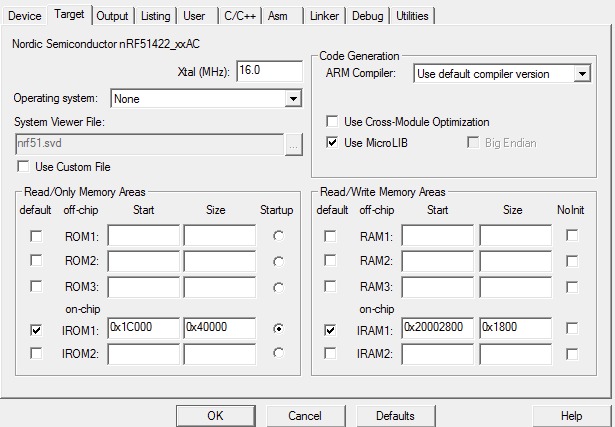

So I want to give you a full description about what we are doing because we could not understand what we did wrong.
Our DK : dk-51 Soft Device : S130_v1 Our IC : nrf51822 qfaa hx0 so our flash (Rom) : 256kb and our RAM:16 kb We are using SDK: 10.00 (We also tried 11.00)
At nrfGo
When we connect our board to our dk it looks like this. WhatsApp-Image-20160618 (2).jpeg
Our Rom and Ram configurations are like :WhatsApp-Image-20160618 (1).jpeg
Interesting thing is when we use Arm mbed to compile we are successfully programming our module but struggling with keil
So could you explain us what should we do to program our module with keil.
