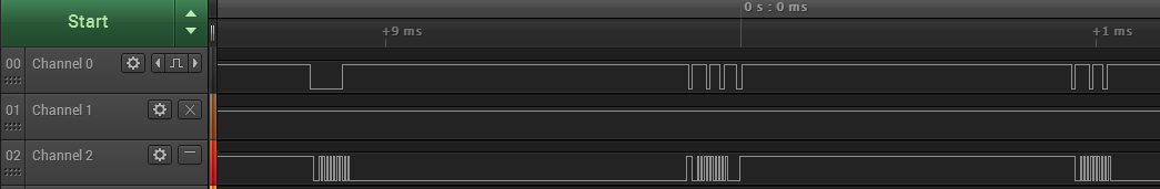

But it does not work. Here is what I observed with the logical analyzer: image description
The first call to the slave delivers a NACK (non-acknoledge) at the 9th clock pulse.

The third call to the slave delivered an ACK at the 9th clock pulse and it was directly followed by the fourth call to the slave which transmitted the register address 0x08. That seems like it is necessary to wake up the slave with the address 0x76 before calling it with the address 0x77.

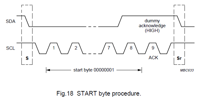

  1. Finally, I tried to follow the Phillips I²C bus specification using a START byte to help synchronizing those chipset. I have succeeded to produce the same chronogram as below which is in the specification: image description
with this code :
uint8_t start_byte = 0x00;
uint8_t slave_address = 0x77;
uint8_t register_address = 0x08;
uint8_t data = 0x05;
ret_code = nrf_drv_twi_rx(&p_twi_instance, start_byte, &start_byte, 1, false);
nrf_delay_ms(1);
ret_code = nrf_drv_twi_tx(&p_twi_instance, slave_address, &register_address, 1, true);
nrf_delay_ms(1);
ret_code = nrf_drv_twi_tx(&p_twi_instance, slave_address, &data, 1, false);
nrf_delay_ms(1);

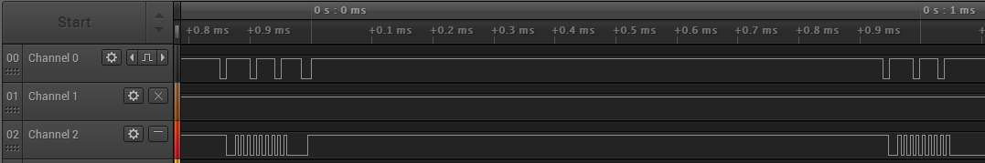

But it does not work yet, as the logical analyzer shows: image description
I come to you again to know if you could help me to find a solution please.
