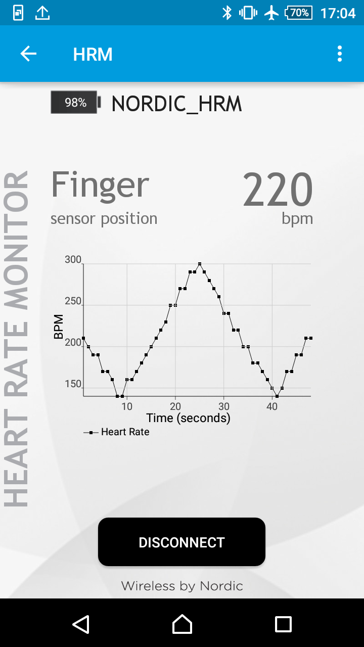

And both LED1 of two nRF52832 devices were blinking in the beginning and then remained "ON" which means two devices were connected, but eventually, I couldn't see any UART output on my Windows 7 with neither Tera Term V4.92 nor Termite 3.2
I also followed UART settings:
Baud rate: 115.200 // 8 data bits // 1 stop bit // No parity // HW flow control: RTS/CTS
Moreover, I've tested the ble_app_hrs using Nordicsemi toolbox App and could successfully receive Heart Rate Measurement from device. image description
So, my problem is how can I observe the Heart Rate Measurement received from BLE Heart Rate Collector on my Windows 7? Any suggestion or settings for Tera term/Termite would be great appreciated!!!
