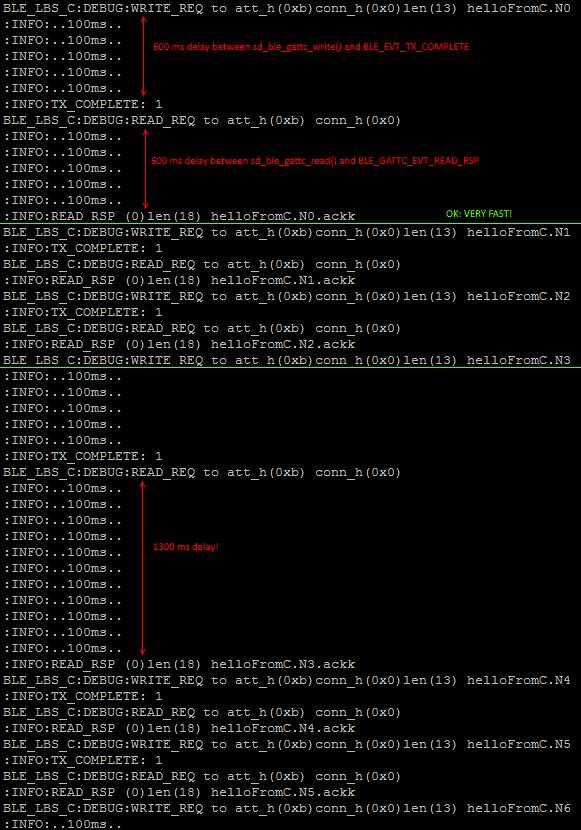

Abnormal slow bitrate (MTU=20). nRF52. SDK12.
Good time dear Engineers!
Faced with a general Problem.
I use two nRF52 boards connection : Central <-> Peritheral. init data: MIN/MAX conn intervals = 10/30 ms
test Algorithm:
  1. Write char value (19 bytes) use sd_ble_gattc_write(conn_h, &write_params);
  2. Waiting for... BLE_EVT_TX_COMPLETE
  3. Read char value use sd_ble_gattc_read(conn_h, char_h, 0);
  4. Waiting for... BLE_GATTC_EVT_READ_RSP
Sometimes, the DELAY between 1& 2 or 3&4 reaches up to 2 seconds, but in other time all good & very fast (immediately). also, I noticed this happens periodically 'in waves'.
WHY? What parameters possible wrong ?
Thanks you!
CONN_PARAMETERS UPDATES DATA (20 ms):
image description
LOG FILE:
image description
