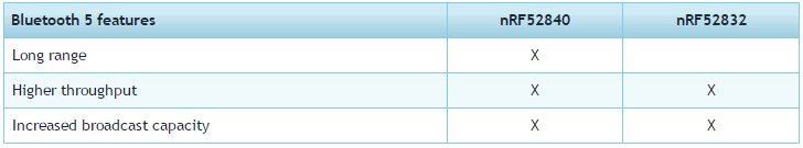

Is there an overview which Bluetooth 5 features are supported by the nRF52832? e.g. higher datarate, or enhanced boradcast payload.
You can read about the Bluetooth 5 features here. At the bottom of the page there is an feature support overview:
I have a nRF52832 dev board from beginning of 2017, do I need to update some firmware on it to get Bluetooth 5 feature support or how does it work exactly ?
I understand some features needed firmware updates, some silicon / hardware updates?
You just need to use the latest SDK / Softdevice, there the new features are supported
