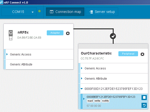

I'm trying to use MasterEmulator with the service from BLE Characteristics, a beginner's tutorial and am not able to get the temperature data because the Datareceived event does not fire. Here is how I have the pipe setup:
    public void PerformPipeSetup()
        BtUuid BtleUuid = new BtUuid("23d113ef5f782315deef12120df00000");
        masterEmulator.SetupAddService(BtleUuid, PipeStore.Remote);
        //BtUuid notifyUuid = new BtUuid("23d113ef5f782315deef1212efbe0000");
        BtUuid notifyUuid = new BtUuid("BEEF");
        int notifyMaxLength = 20;
        byte[] notifyData = null;
        masterEmulator.SetupAddCharacteristicDefinition(notifyUuid, notifyMaxLength, notifyData);
        pipe1 = masterEmulator.SetupAssignPipe(PipeType.Receive);
        //pipe2 = masterEmulator.SetupAssignPipe(PipeType.ReceiveRequest);
and here is what I see in nRFConnect
image description
I noticed that I have to toggle notifications in nRFConnect to get notified. Do I have to do something similar to get this working with MasterEmulator? Do I need to use SetupAssignPipe for the Read and Write?

  • Have you called OpenRemotePipe or OpenAllRemotePipes after you get connected ?
    The Receive pipe need to be "open" to be able to receive notification. Open here means to toggle CCCD/notification.
    Also you have to make sure you have your characerteristic UUID match with "BEEF" UUID you used. It's not a standard Bluetooth SIG 16Bit UUID, but you can use for testing purpose.

    Note that the 0xBEEF UUID in the tutorial is 128 bit UUID with the base UUID = BLE_UUID_OUR_BASE_UUID, it's not the 16bit UUID like you are using now. You should check the UUID when you use nRFConnect or Master Control Panel.

  • I was able to get this to work by using the following in PipeSetup:
            BtUuid BtleUuid = new BtUuid("0000F00D1212EFDE1523785FEF13D123");
            BtUuid notifyUuid = new BtUuid("0000BEEF1212EFDE1523785FEF13D123");
    OnDataReceived is now firing.
