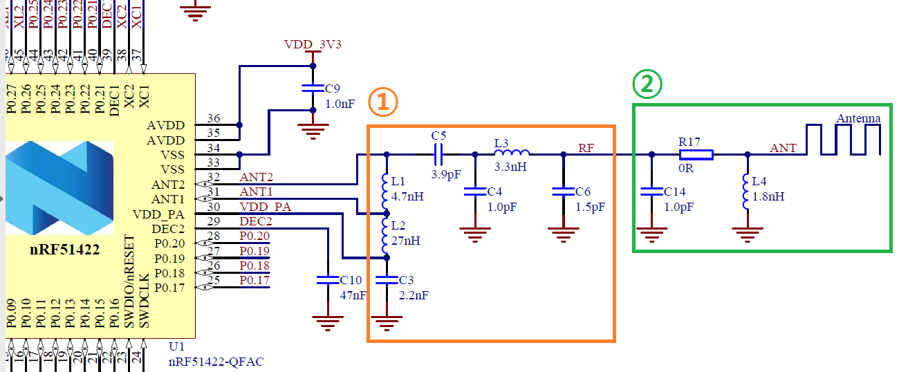

and he wants to use the meander antenna which is drawn at the PCA10031.
My questions are;
Antenna
  1. Although the nRF51822-QFAA and the nRF51422 are similar,
I want to know whether it is fine to use the same values for the RF and the antenna components, the RLC values.
I'm planning to use the FR-4, 1.6mm thick, 2-layered PCB.
Can I use the same components, which is described in the PCA10031's schematic, when I work with nRF51822-QFAA?

  1. I just want to double check.InvertedF
Compared to the Inverted F antenna, the meander antenna, which is drawn on PCA10031, doesn't connect the antenna trace to the ground plane, right?

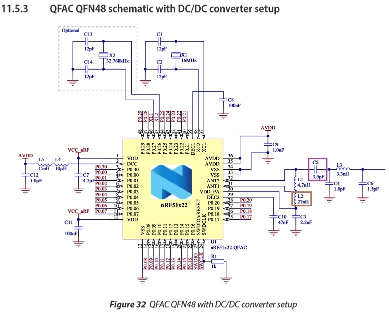

  • Hello MANGO
    The chip on the nRF51 dongle is the nRF51422-QFAC. This package is a little larger than the QFAA and QFAB packages and the matching network is therefore a little bit different to compensate. For the correct output network, please see the reference schematics for nRF51822-QFAA QFN48 on pages 82-87 of the nRF51822 product specification. Specifically you will see that the inductor L2, and capacitor C5 have different values.
    Correct, the meander antenna will not have the arm shorted to the ground plane as the IFA has. Please keep in mind that any changes to the PCA10031 antenna design will require changes to the antenna matching network encircled in green in your figure.

  • Thanks for your answer, Jørn!
    1. In the product specifications, it is written as "nRF51x22". Just to double check,
    the nRF51822-QFAA / nRF51422-QFAA or the nRF51822-QFAC / nRF51422-QFAC use the same RLC components for network matching, right?

  • My pleasure!
    1. Correct. Both the matching networks and the radio hardware is identical for the nRF51822 and nRF51422.
