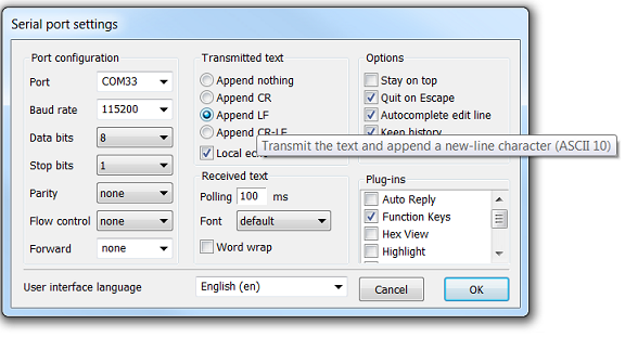

  • Using the ble_app_uart example, you should be able to see both the data you send(from the app) and receive(from nRF51 via PC/UART).
    Note that the data in your UART terminal(on PC) will not be sent to the phone before you either send a newline character('\n') or the data string reach BLE_NUS_MAX_DATA_LEN characters (20).
    Relevant code-lines:
      if ((data_array[index - 1] == '\n') || (index >= (BLE_NUS_MAX_DATA_LEN)))
                    err_code = ble_nus_string_send(&m_nus, data_array, index);
                    index = 0;
    In e.g. Termite terminal program, you can configure the text to be transmitted with new-line character by selecting the "Append LF" option:
    image description
