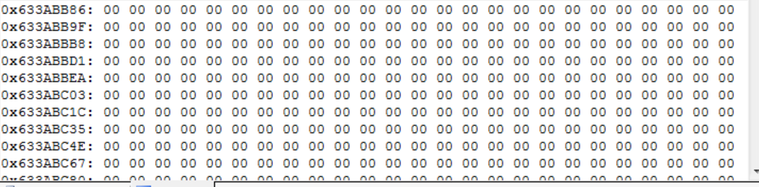

Program skipping reset handler and system init in .s file right to a logging function
To my understanding, normally, either after a reset or powering up, the program should first run to Reset_Handler, then SystemInit, then __main.
Somehow, my program runs to none of the places above, and if you F11 all the way down (I'm using keil uv5), it will eventually hit this function:

Or if you hit F5 on keyboard and let it run, it will go through none of those function (I set breakpoints there), and eventually stop at here, which is a random place by the look of it:
image description
And this is what it looks like at address 0x633abb86:
image description
Any idea how to approach this problem?

  • @endnode Can you shed some light? I haven't the faintest idea how to deal with this. Line by line I walked through the first 80? or so assembly codes but none of them made any sense. I also got a 0xCAFEBABE return code of some sort in r3 register but I have no idea who returned it.
  • I'm not sure what is going on. Could you share your complete project so I can test it here? Which SDK and SoftDevice are you using? What kind of hardware?
