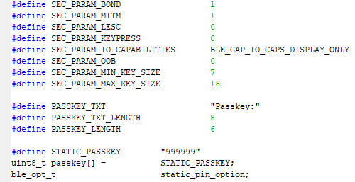

so I follow nordic devzone and add the static passkey method in ble_gls example like this
image description
image description

    If you have a look at line 225 in your main.c you can find in PM_EVT_CONN_SEC_CONFIG_REQ event you send conn_sec_config with allow_repairing = false. This mean you tell the device not to let the phone to re-pair to your device. So either you change this option, or you erase bond information on the device so you can have a new bonding to the phone.
    This is the default behaviour because it avoid attacker to spoof that the phone losses bond information and can replace the original bond with a new bond.
