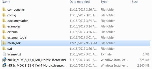

    We have this example combining SDK v14.2 and Mesh v1.0
    You should follow this instruction:
    1. Download the mesh SDK v1.0 and nRF5 SDK v14.2
    2. Extract Mesh SDK v1.0 into nRF5 SDK v14.2, and rename the mesh SDK v1.0 to “mesh_sdk”, so the file structure will be like image description
    3. Extract the “ble_app_uart_mesh.zip” into “nRF5_SDK_14.2.0_17b948a\examples\ble_peripheral”
    4. Open the SES workspace and compile the project, and program to the nRF52-DK
    5. You can use “nRF-Toolbox UART” to test the firmware, after the client provisioned servers, you can send asci ‘0’ ~ ‘3’ to through NUS to control LEDs on servers.
