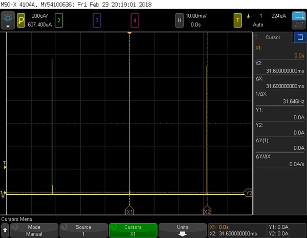

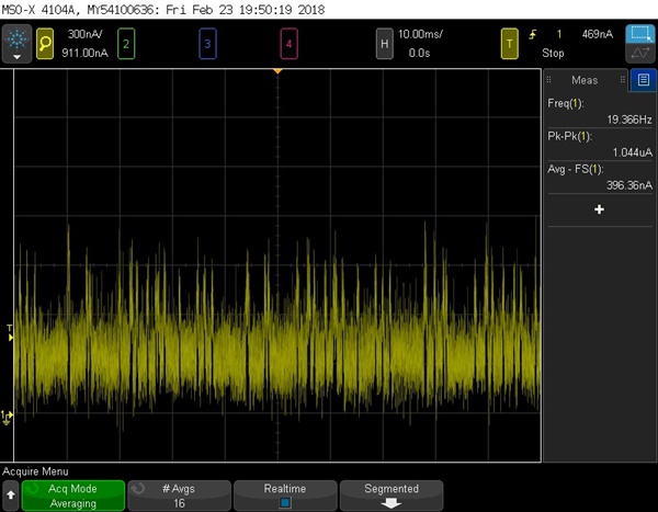

When I flip it to ON, I obtained the following measurement:
System on, low power mode:
System off, after pressing Button 1:
The result seems to make sense but there are a lot of little peaks in the waveform.
When I zoomed out, there is another peak which doesn't seem like noise:
The peak lasts for around 300ms and repeats for at 30Hz. I wonder if this is the capacitor peaks mentioned in this link:
https://devzone.nordicsemi.com/tutorials/b/hardware-and-layout/posts/current-measurement-guide-introduction
but it is way too long than what is mentioned in the link (10-15us) and it is definitely not the peak for the app timer created in the pwr_mgmt module.

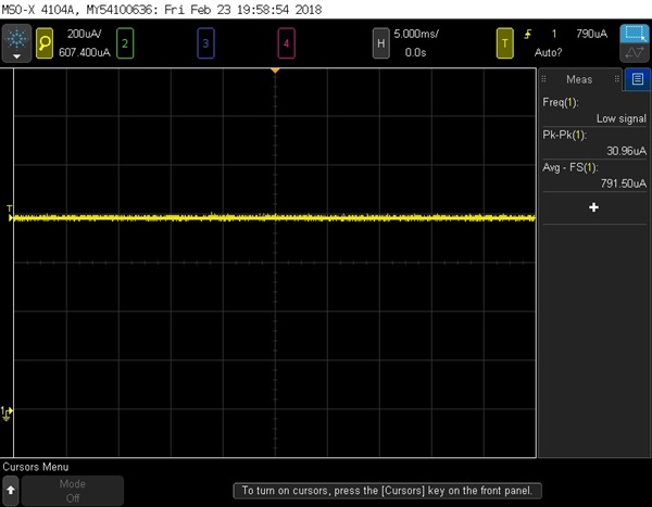

When I flip it to OFF:
The current immediately rises:
This also happends when I plugged out the USB cable connected to J2, but the SoC should still be working since I use an external supply for it but why it has such radical behavior when the sw is flipped to ON and OFF? What am I missing here?

  • Hey Jiaming,
    The Preview DK is not fully power optimized yet. I measured on a PCA10056 V0.8.1 and compared it to a V0.12.0(still preview) both running the power management example from SDK14.2, using our Power Profiling Kit.
    Above V0.8.1, below V0.12.0.

  • Thanks for your reply. May I know more about the 'not power optimized' part? Exactly what will it do that is not optimized?
    I now have no guildline on how much current would be correct as their differ quite a lot as shown in my measurement. With some search on the DevZone, I think a current consumption around 1uA when it is low power mode would be an acceptable value, as shown in your measurement as well, but I worry that it could just be a false measurement.
    Perhaps you could help me out on the recommended settings of the switch positions? Such as, should I turn SW8 to ON when I measure current? Since I use an external supply for the SoC, I think SW8 turns on the supply to the rest of the circuit, but some how it affects my current measurement with more than 700uA consumption.
    By the way, my preview DK is v0.9 with the last number forgotten by me.
    Thanks.
  • The nRF52840 DK have a really complex power supply that will enable us to fully isolate the nRF52840 reference design from the rest of the DK by flipping the SW6 to 'nRF ONLY'. This is a work in progress and there are bugs in the preview kit's power supply and isolation circuit switches. As of now you cannot make accurate measurements of the current consumption. You will have to wait until the final DK is released.
