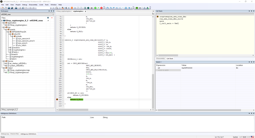

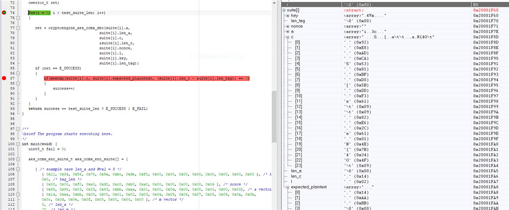

During implementation of a test set for CryptoCell AES CCM* functionality i'm facing some issue with the CryptoCell.
Encryption works fine without any issue. When it comes to the decryption parts only first test set passed whereas the second fails with error code 0x00F5000, CRYS_FATAL_ERROR.

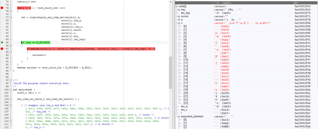

  • OK, I found a bug in the code - you have bad memory alignment!
    CRYS_AESCCMStar expect to have 16 byte for Mac_Res. You are not passing that.
    So you need to increase your arrays in structures aes_ccms_enc_suite_t and aes_ccms_dec_suite_t:
    uint8_t m[20 + 16];
    and
    uint8_t c[20 + 16];
    Once this is done you will observe that your encryption test vector (suit[0]) is broken. Cipher text is not matching expected ciper text.
    Test vector suit[1] is fine for encryption and decryption.
