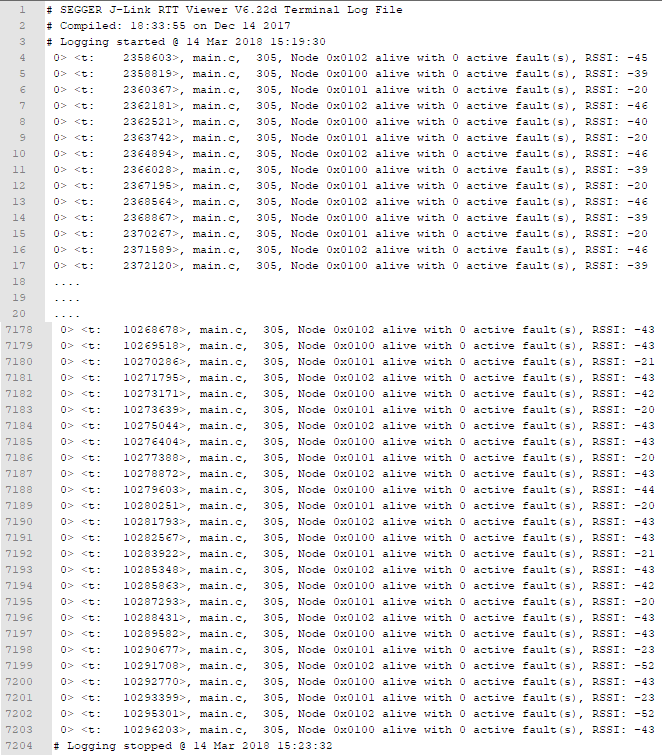

    This will obviously request each provisioned server to send 10 messages a second across the mesh, with the expectation that the 3 servers would push 30 such heartbeats each second. Based upon the results, both reliability and throughput can be measured. The results we see in our environment are as follows:
    So across a 4 minute and 2 second time-span (242 seconds), we're seeing 7,200 messages across the mesh which equates to approx. 30 per sec. which in turn is reflective of the 30 heartbeats that we expected (The mesh spec limits each node to 24 Hz so this is within spec)
    You could additionally amend your environment by increasing the distance between the server nodes and the base client (and adding simple relay nodes where required). Again, the above doesn't mimic your command/response model but it does allow you to at least verify mesh throughput with a single line change to the basic example code.
    I'll try to implement your model in our environment and post back if I see any extraneous results.

  • hello aleccontrol,
    I just re-downloaded both the v1.0 and v1.01 Mesh SDKs from the Nordic website and they both have the  case PROV_STATE_CONFIG_PUBLICATION_HEALTH: set to ACCESS_PUBLISH_RESOLUTION_10S. (Possibly you are confusing this with the case PROV_STATE_CONFIG_PUBLICATION_ONOFF: case which is directly below in the code). So i'm not sure if that setting pertains to your issue.
    In any case, I went ahead and implemented the simple_on_off model that you attached within our environment. As you suggested, we commented out the UART comm1_strout functionality and simply echoed back out the received command string along with a counter value to iterate through the responses from each server node. We set the send_command_client(&m_clients[GROUP_CLIENT_INDEX], command, 4); function to trigger every time we received a heartbeat message from any of the 3 provisioned nodes.
    So in the above scenario, the 3 server nodes send out a heartbeat message (at the specified interval, we tested 1 sec and 0.1 sec) which then triggers the client node to send the "Test" command to the 3 servers which each then send back an echoed response.
    Needless to say, we are not seeing the same throughput issue that you have reported. I have attached the RTT log file from the 100MS (0.1 sec) test run that we analyzed over a 5 minute (300 sec) period. Within that log we see significant mesh network throughput (albeit a simple echo of the "Test" string with a counter value returned). We do however see approximately 25% packet loss at that message frequency.
    rtt-log-100ms-cmd-resp[3-svrs].zip

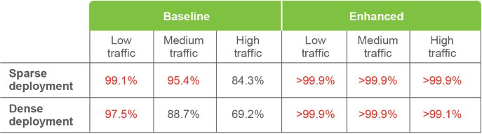

    • a. 3 heartbeat messages (server(s) -> client)
    • b. 1 command message published to the group (client -> server(s))
    • c. 3 response messages sent to the client (server(s) -> client)
    Given that there shouldn't be any relaying taking place (the nodes are within close proximity and message caching would ensure that repeats are avoided), that means 70 messages every second across the mesh. Also, we haven't done any timeline analysis to determine if there's a specific point(s) within our basic test where we start to see packet loss or whether the loss was uniform.
    I do recall reading a vendor produced whitepaper, where circa 900 mesh devices were deployed over a 2,000 sq m. area with a target response time/latency of 300 msec being set for message delivery in message traffic configs of (low - ~150bps) - (medium - ~1kbps) - (high - ~3kbps). I grabbed a screenshot of the results at the time (see below), which highlighted that at least 99.1% of messages were successfully delivered with 300 msec latency across a high traffic (enhanced configuration) in both sparse and dense deployments. I recall that enhanced meant that source message re-transmissions were performed as well as advertising randomization whereas Baseline was a standard mesh implementation. Also note that this wasn't Nordics's mesh stack!! (If you are interested, let me know and I'll see if I can dig out the link to the whitepaper.)
    I guess the general takeaway(s) from the above would be:
    1. that we shouldn't base any firm design decision(s) on the packet loss figures that I provided (since the config is/was not optimized or validated)
    2. the High traffic w/Dense deployment Baseline stat (69.2% - from the table), does reflect a similar level of degradation to what we saw in our basic test
    3. there are Enhanced optimizations that can be implemented to increase mesh reliability and throughput
    4. the results reflect fairly well on Bluetooth mesh when compared to results i've seen across Zigbee, Z-wave etc. based on lower device numbers (the caveat being that this is only one specific configuration under test)
    I hope the above helps.
