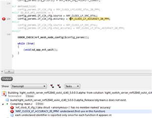

    3) It has taken many hours of toying with this project to get this far and now the raised error is:
    Any ideas on how to resolve this error? From our limited knowledge, this define is for older SoftDevices (ie. S132 - according to the Nordic keyword search results) but we are on S140?
    There has to be something we are doing wrong for this to be taking so many hours and still unable to compile for the PCA10056 target (Mesh Light Example). Perhaps wiser to just order a few of the PCA10040 kits for testing. With regret, we thought we could run the mesh stack on the nRF52810 (read that somewhere in the docs) but that is not supported and is not on the roadmap? So the kits we just brought in from Fanstel will not allow us to be used for mesh networking. Also brought in the PPK which is apparently not working in low power mode - we wish to validate that the PCA10040 / PCA10056 can indeed enter low power mode to deploy with a CR2032 coin cell battery for a long period of time.

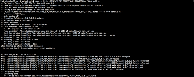

  • Hello, I suggest that you download the mesh sdk v1.0.1 from the beginning, extract it. When this is done then navigate into the sdk root through the terminal, do
    1. mkdir build && cd build
    2. cmake -G Ninja -DGENERATE_SES_PROJECTS=ON -DPLATFORM=nrf52840_xxAA ..
    This will generate the Segger project for pca10056 nRF52840. Just to mention you will need python and pip installed in order to generate Segger project. Also you will need to install jinja2 by doing pip install Jinja2 in the terminal. Afterwards you should see Segger project in the examples/light-switch/client or server example.
    Hope it helps!
  • Hi Kumar,
    There must be an issue with the path, in my case the project worked out of the box. I suggest you to try with a fresh copy of the SDK. Make sure you use v1.0.1
    If it still doesn't work, please zip your example folder and we can test here.

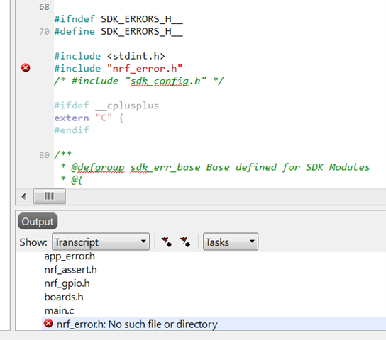

    2) Even with following the above procedure that we just made aware of -> still raising an error of missing:
    From what we can see, this missing nrf_error.h file is inside the S132 softdevice folder. However the S132 softdevice is not valid for PCA10056 target or is it ok?
    The Segger include path does not offer searches for the S132 folder. Urghhh!!!!
    Our path structure does not include any reference to the S132 folder hence the raised error.nrf5_SDK_for_Mesh_v1.0.1_src.zip

  • Hello, I downloaded the attached zip file and there seem to be missing files during the compile when doing: cmake -G Ninja -DGENERATE_SES_PROJECTS=ON -DPLATFORM=nrf52840_xxAA ..
    Did you do this step, and if so did you get something like this during the compilation?
    I ran the Segger project and got same errors as show in your post, after compiling the mesh sdk the errors disappeared. I'll attached your project here have a check,
    3108.nrf5_SDK_for_Mesh_v1.0.1_src.zip
