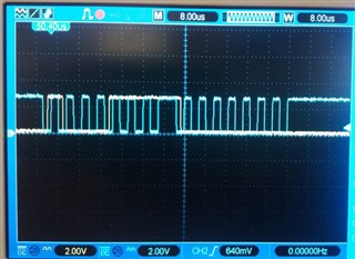

    I appealed to the oscilloscope and this is my SPI bitbang that works
    Blue is the clock and yellow is the mosi of 0x8f (read whoami)
    mosi (y) and clock (b) of 0x8F
    Blue is the clock and yellow is the chip select
    Chip select (y) and clock (b)

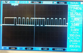

    Now the part that doesn't work, from the nordic sdk api call to spi.
    Please note that this is on MODE 0.
    spi_config.ss_pin    = SPI_SS_PIN;
    spi_config.miso_pin  = SPI_MISO_PIN;
    spi_config.mosi_pin  = SPI_MOSI_PIN;
    spi_config.sck_pin   = SPI_SCK_PIN;
    spi_config.frequency = NRF_SPI_FREQ_125K;
    spi_config.bit_order = NRF_DRV_SPI_BIT_ORDER_MSB_FIRST;
    spi_config.mode      = NRF_DRV_SPI_MODE_0;
    Clock (b) and mosi (y)
    Blue is clock and yellow is the chip select
    clock (b) and cs (y)

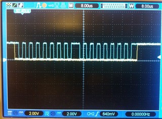

    Blue is the clock and yellow is the mosi of {0x8f,0xff} (read whoami), like suggested
    Clock (b) and miso (y)
