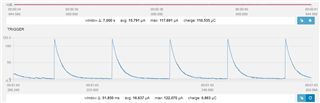

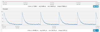

    I've also compared the current consumption between the two:
    With PPI:
    With CPU interrupt:
    As you can see the difference is dramatic. The RTC interrupt will also be at the mercy of it's execution/preemption priority, whereas the PPI system is completely independent from the CPU state.

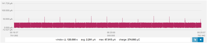

  • Hey butch,
    I've taken new measurements at an interval of 10s.
    Interrupt:
    PPI:
    As you can see there's not much difference between the average current consumption, but the peak is halved with PPI. You should definitely use PPI + GPIOTE as it is entirely independent of the CPU activity (SoftDevice has the highest exectution priority).
    The base current is somewhat higher with the DK than just our reference design, so you should expect a slightly lower current consumption in your product.
    Cheers,
    Håkon.
